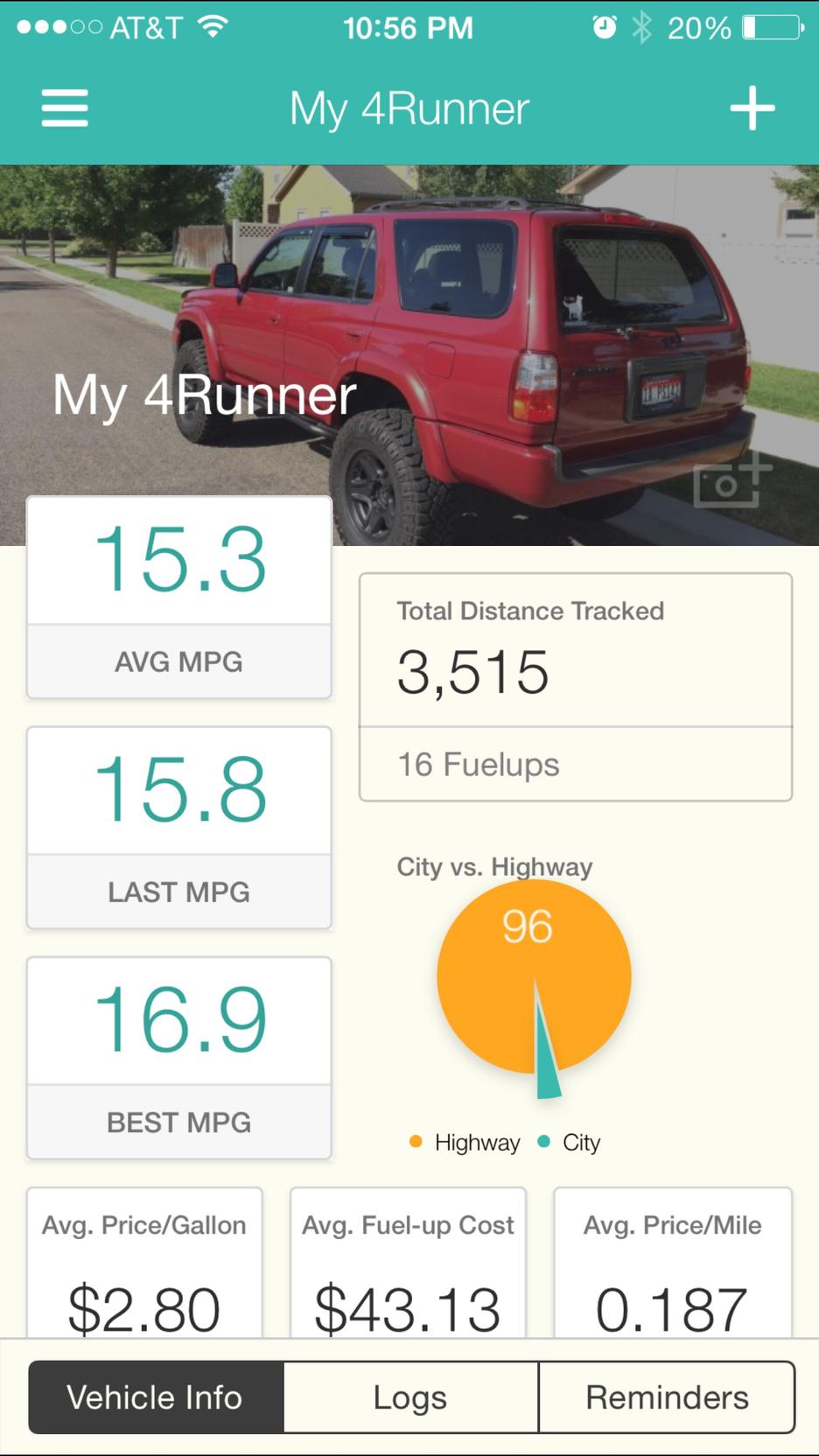

I have 285/75/16 tires
4.10 gears
Auto trans
75% city as my DD
