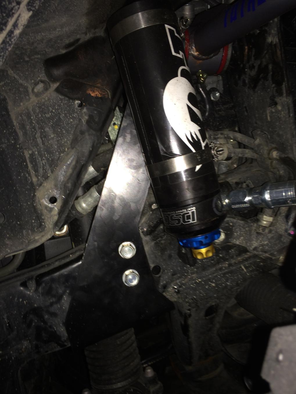

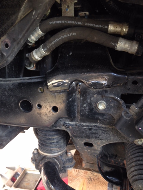

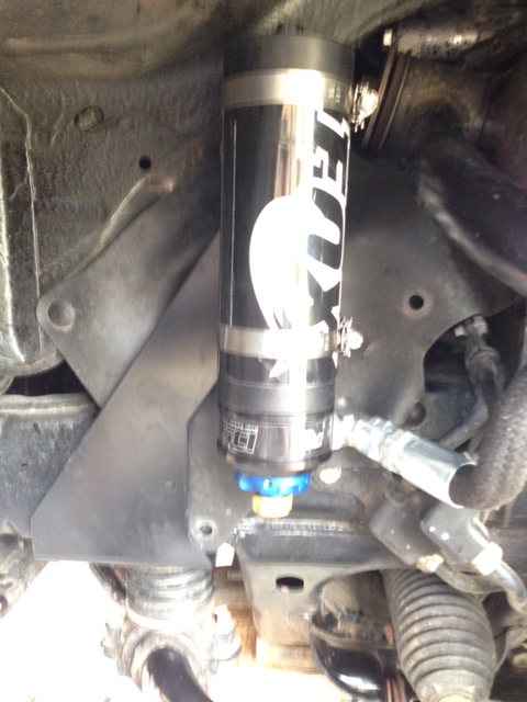

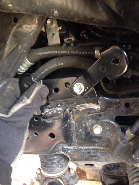

Below is what mine looks like.
I just removed the hose guard since the bracket will be taking on that roll. Cut it nice and you can easily weld it back on if you remove the shocks.
EDIT: added pics, sorry last pic is crappy. I actually welded nuts to the factory location as, since i think mine was one of the first they didn't ship with self tapping nuts. Also I tried to explain to them that I thought the clocking on the hydraulic fittings/lines is off but it works. I'll have them checked when I send them in to get rebuilt in a few years.

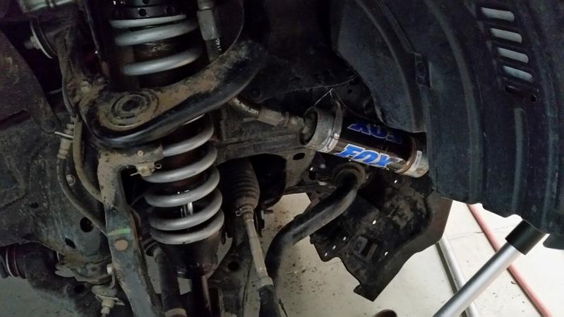

I bought a set of FJ Cruiser coilovers and was assured by Fox that they were the same as the 4runner. Then I went to install and the lower mounting bolt on the FJ is 12mm and it's 14mm on the 4runner. So it wouldn't fit. I called fox. They said it was because I have a '15 and they only make shocks up to model year '14 and the '15 must be different. I said that's not correct and we had a stalemate.
It only cost $9 each for the new lower joint bushings for 14mm, so not a big deal - but they ARE different. Also the mounting is significantly different for the reservoir. I just took the FJ Cruiser mounting set and made my own out of them in about the FJ Cruiser location. No big deal. And it fits around the KDSS easily. BUT... I do rub just a tad at full steering lock in reverse. At some point I'll fix it. I paid $400 for the set so I'm OK with it.
Here's how mine are mounted
