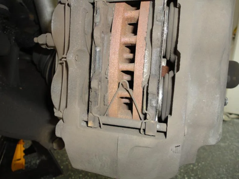

JayRolla is correct. You need some anti-rattle springs that go between the inner and outer pads. They help push the pads back towards the pistons to reduce NVH and pad wear. I don't believe they were ever made for the 4Runner or Tundra, but they should be easy to retrofit.
dsc00948-jpg.510639
https://www.amazon.com/Toyota-47748-60061-Disc-Brake-Retaining/dp/B00KTHVGZW
^Landcruiser parts
dsc00948-jpg.510639
^Landcruiser parts
I had these springs installed also but there was still an unsettling amount of gap between the pistons/pad/rotor. They were brand new but didn't hold them apart hard enough.
