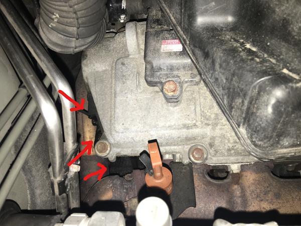

Pics as promised.... looks like its leaking when facing the front of the engine in back left. I couldn't really get a good picture but hopefully the red arrows show you where it's leaking. I also looked underneath and it appears it's running down the oil pan on the same side of the valve cover where it is leaking. I'm thinking a lot of the leaking is around the half-moon area based on the area. I don't have puddles of oil but every morning there is usually 1-2 dime size spots of oil on the floor.

Put your hand back there when the engine is cold, if it's really wet, that is your culprit. Also your trans should be really oil if it's dripping on the floor. That is the rear cam seal and mine was the source of my leak. I remedied this when I did the valve cover gaskets a month ago, but mine never made it to the ground. Keep an eye on your oil level too.

This is how mine started, and then got worse. I thought is was the valve covers as well, but mine ended up being the cam seals. If it weren't for replacing the water pump, timing belt, and thermostat. I would have gone after the valve covers first, and then had to go back.
