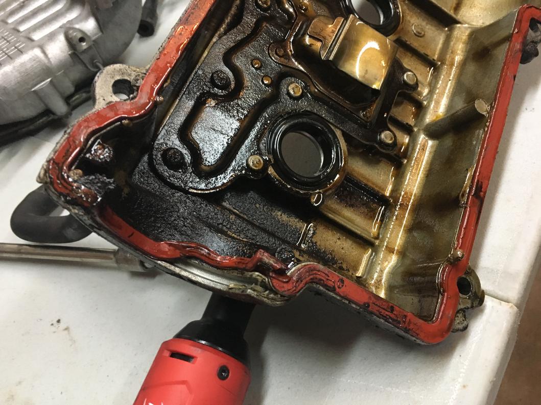

Yep, it happens. I found out why mine was leaking so bad. Not sure how someone did this. Replaced everything with all toyota parts.
