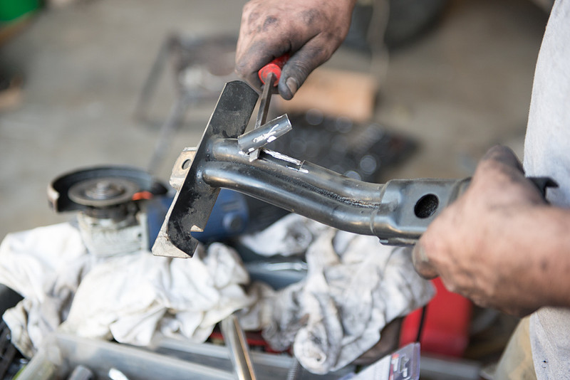

The fronts required modifying the left radiator bracket, some fabrication work was performed to clear the sway bar. The supplied spacers didn't allow enough clearance.

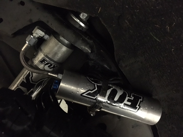

I don't believe the correct rear shocks were sent. When mounting the reservoirs to the shock body with the supplied clamps, the reservoirs contacted brake lines and many other parts if suspension was compressed. Ended up routing them to the side but I don't think it can be a permanent solution. I will be contacting Fox soon about this.

Is this what you had to do to the support bracket?
I had similar issues in the rear
I left them as is for now and I keep checking them to see if they are contacting the brake line.

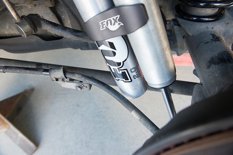

How close are the coils to your sway bar?
