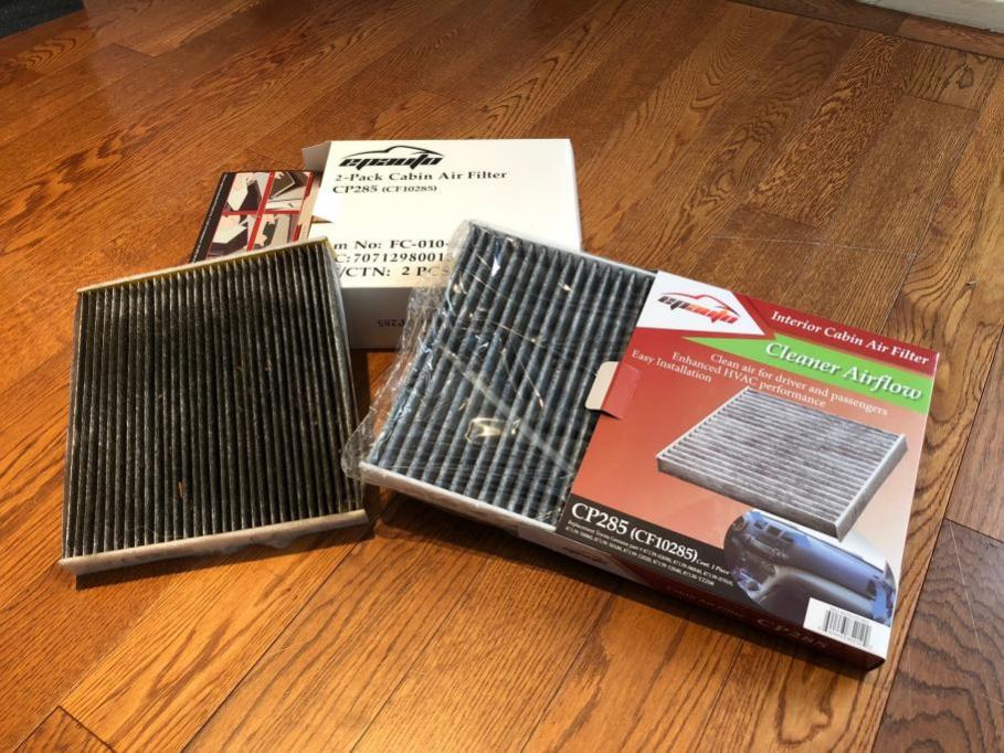

One thing to consider when choosing an air filter is pleating, meaning the number of folds across the face of the filter. Most filters are about 1" thick, and obviously if they are made to fit, are all the same width and depth. If you choose a filter with more pleats, it will have a larger total surface area, and it will provide maximum air flow for a longer period of time before it's used up.
It's not a critical part, but a nice feature to have, so I like to get the most bang for my buck in this scenario, versus something like an oil filter or engine air filter, which I'll spend more to get a premium brand, usually OEM.
I bought a 2 pack from Kootek on Amazon for $12. 23 pleats for $6.
Yeah, you can see in the photo the aftermarket filters that I purchased have fewer pleats than the OEM part. I'll be looking at that detail more closely, the next time I am ready to buy.
