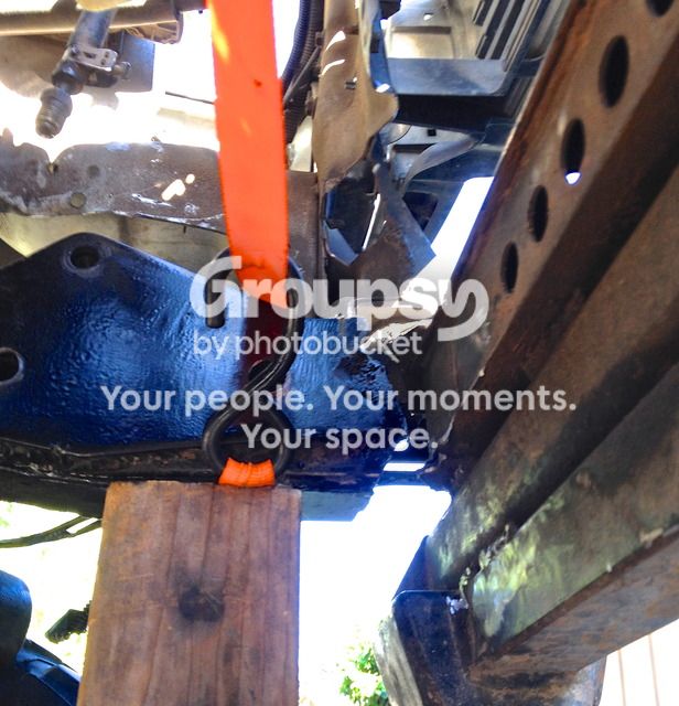

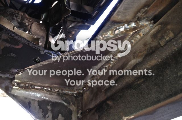

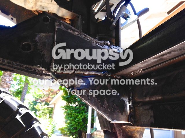

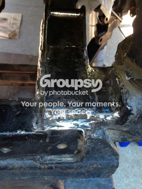

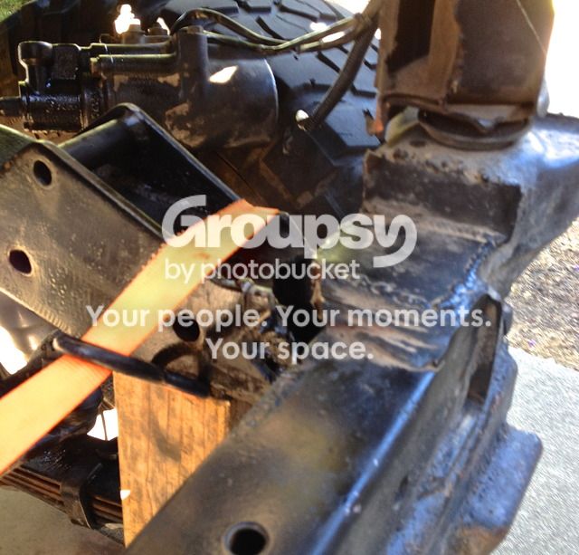

for what it's worth , I literally broke my frame in two on my 90 4runner. I just welded it back together with a bunch of gussets and extra braces where it broke...frame damage doesn't need to be a death sentence for ur truck...
