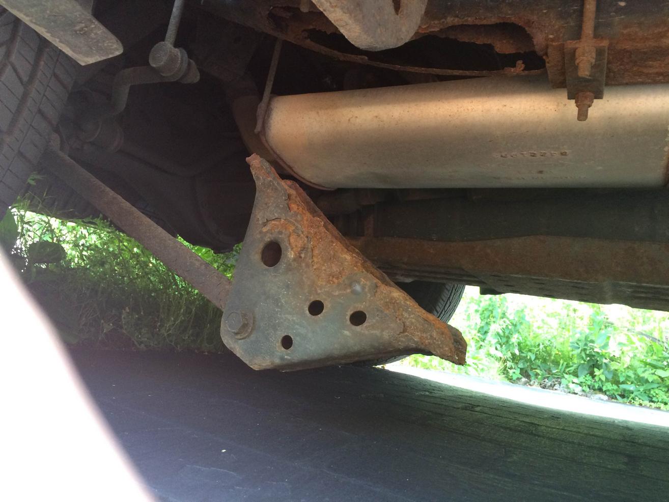

I've been trawling the Forums here for a couple years since I bought my 3rd gen 2000 SR5 w/5speed, but this is my [second] post (posted a couple days ago in an old frame issue thread, to no avail). Not to beat this dead horse that is 3rd gen frame rot discussion, however I have a genuine issue.
The other day while driving home, my passenger side rear suspension linkage disconnected from the frame, leaving the transfer case floating. This happened due to the fact that the frame has rusted completely through, as you'll see in the picture (you can also see where there was some apparent "reinforcement" work done to the frame in this area).

If all else fails and I do end up needing to repair the frame, I'm looking for opinions. Those of you who have done the weld repairs, (Wallace) how are they holding up? How much did you end up spending in entirety on the frame welding jobs? I absolutely love the truck and don't want to lose it, however there comes a point where I need to cut and run, so right now I'm deciding if I'm there or if it's salvageable.

That sucks. I had some welding done on my frame in that same spot and it's held up fine - you can see it in the link in my signature. I did mine preemptively before it snapped. $800 is probly what some automotive professional quoted you I assume. I had some good ol boys do it for $200. It's probly the strongest part of the frame now.
You and I obviously won't be owning these things forever, but a couple hundred bucks and some welding will give you time.

I would continue to look into if you have any legal recourse, although you may not. If the car has been on the road since then, the dealer you purchased it from may have had zero knowledge of that issue and may not be liable at all. As far as repair goes, personally I wouldn't repair that. If that section is that bad, then so are other parts and you're just waiting for more failures. This time it seems like you got lucky since the failure didn't cause an accident but you never know what could happen with a suspension failure like that. Your best bet might be to try to find a frame form a salvage yard that's in better shape than yours and do the work to swap it out.

It would be good to examine the entire undercarriage and look for any other trouble spots, or have a fabrication shop look it over. You don't want to drop $800 and then after next winter have something else fall apart.

Looks like it rusted out a lot of the frame. It'll be hard getting to the top of the frame if there's a place without rust to weld to. just be careful around the gas tank.
