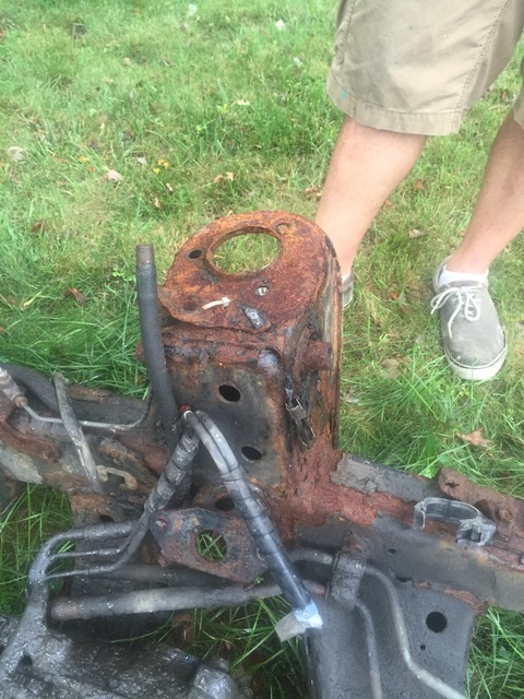

Many thanks to Crowcifier6 for checking out the frame for me and getting some better pics before I make the four and a half hour drive to see this thing. He took the pic I have attached/inserted here. I was wondering if anybody could help me with what I am seeing there on top of where the driver's side front strut would attach to the frame. Is that like 1/8" of rusted frame peeling off the top of that or is that the remains of a gasket or bushing or something? It kind of looks like something a little more consequential than surface rust to me. What do you guys think?

I know what that is. It's the bracket for the ABS wire that is clipped to the strut tower. It's a steel plate. If the pic was better you could see the front edge, but the rust all blends together. Take a look at my old frame and you can see it:

So I'd say it's probably ok. You're gonna have fun cleaning that one up. The key is that area under the control arm brackets. Good luck. I'm here to help if you need it (over the web). I was only in the NEK once, but I had a great time. My college roommate was from Hardwick, VT and they had a hunting camp up there. Too bad it's so far from NJ.

TheDurk nailed it, it's just a bracket. I'd be slightly more concerned about the fact that TheDurk's old frame looks better than this, though.
But the real test is the rear lower control arm bracket area on the frame. How do they look (both sides)?
Didn't really go over the whole thing with a fine tooth comb when I checked it out for him... to me it looked workable, don't know OP's expectations... I am no expert.
