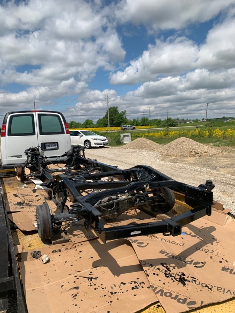

I’m doing a frame swap on mine because it’s beyond repair. The donor frame that I bought didn’t have any rust at all but I still coated it with POR and sprayed the inside with Eastwood because I live in the rust belt too. I say do it all at once and don’t do it again.
How did you go about getting a donor frame?
I found it though searchtempest.com. It’s a website that lets you search multiple cities of craigslist. Or even certain regions. I ended up buying mine from Tennessee for $250.
