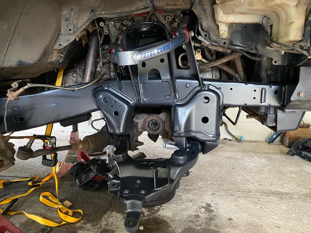

In the end I went with POR-15.
Spent many, many hours with a needle scaler and wire wheel on my angle grinder removing any and all flaking rust. Not so bad as it gave me chance to confirm no areas of the frame were really rotted or needed attention, just surface rust & flaking.
I didn’t top coat after applying as didn’t want the shine to remain. After nearly 2 years it’s faded to a chalky black which I don’t mind.
Still do my best to keep it off the winter roads as the roads near me are treated with rock salt.

It seems like you haven't done any of the prep work on the frame yet. If that's the case and it was my vehicle I would just descale the loose stuff and use corroseal rather than spend the extra prep time getting all the rust off to use a different paint. Just my two pennies on the subject. I'd like to think of myself as productively lazy lol
You aren't wrong and I don't want to go down the completely slippery slope of attempting to make it perfect.
This is a new to me truck and I'm in the process of a complete maintenance effort: suspension refresh, hose replacement, fluid replacement, brakes and frame revitalization. Once it's back on the road I'll turn to the engine - timing belt, hoses, etc. etc. yada yada.
I've currently descaled 40% of the problem areas and cut out the two parts that needed cutting out. Still need to thoroughly clean out the inside of the frame and decide what to do.
I don't like the look of pock marked metal but unless I reframe it, I will have to get over it in some places.
So, perhaps corroseal is indeed the best answer. Thing is, not all of the frame is to be scrubbed, I have plenty that still has original paint on it. Guess I can corroseal the places I clean up, and then scuff the existing paint for adhesion.

I think you would be fine overlapping the corroseal onto the still painted sections of frame as long as you scuff if up, then scuff up all of it and paint with the rustoleum to blend it all together. Most people never look at a frame besides making sure it's still there lol
Good call on that. This will likely be my approach.
