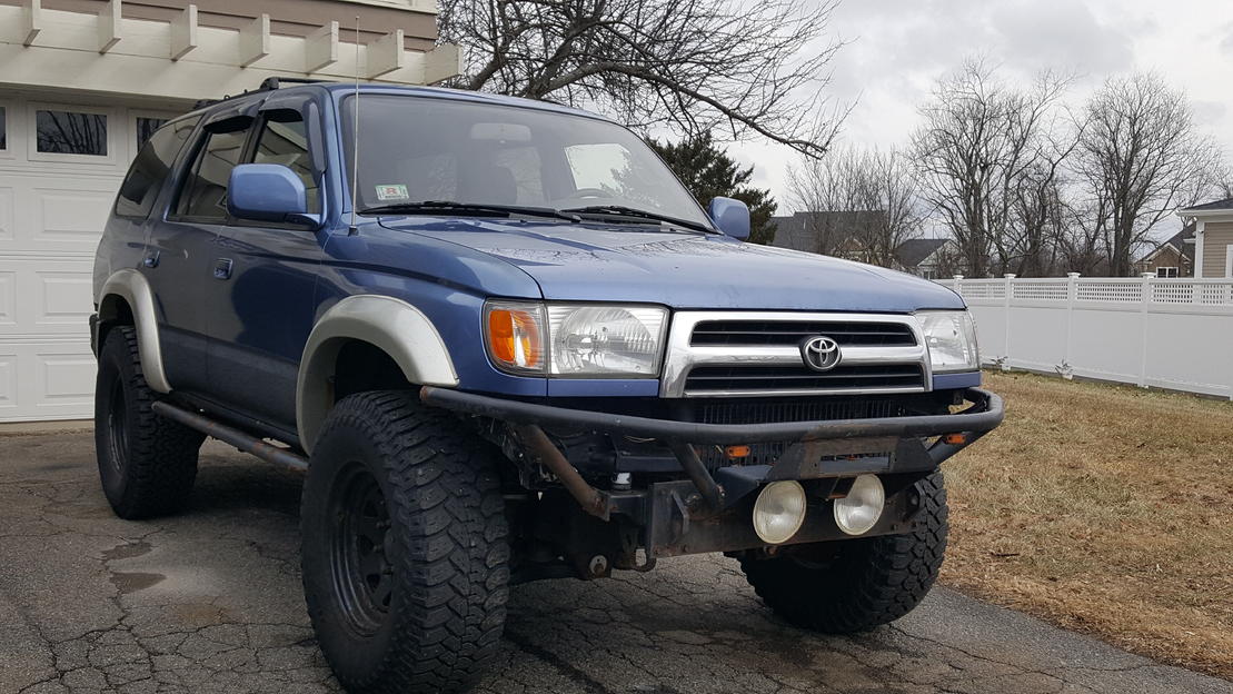

<a href="https://imgur.com/yegNEJn"><img src="https://i.imgur.com/yegNEJn.png" title="source: imgur.com" /></a>

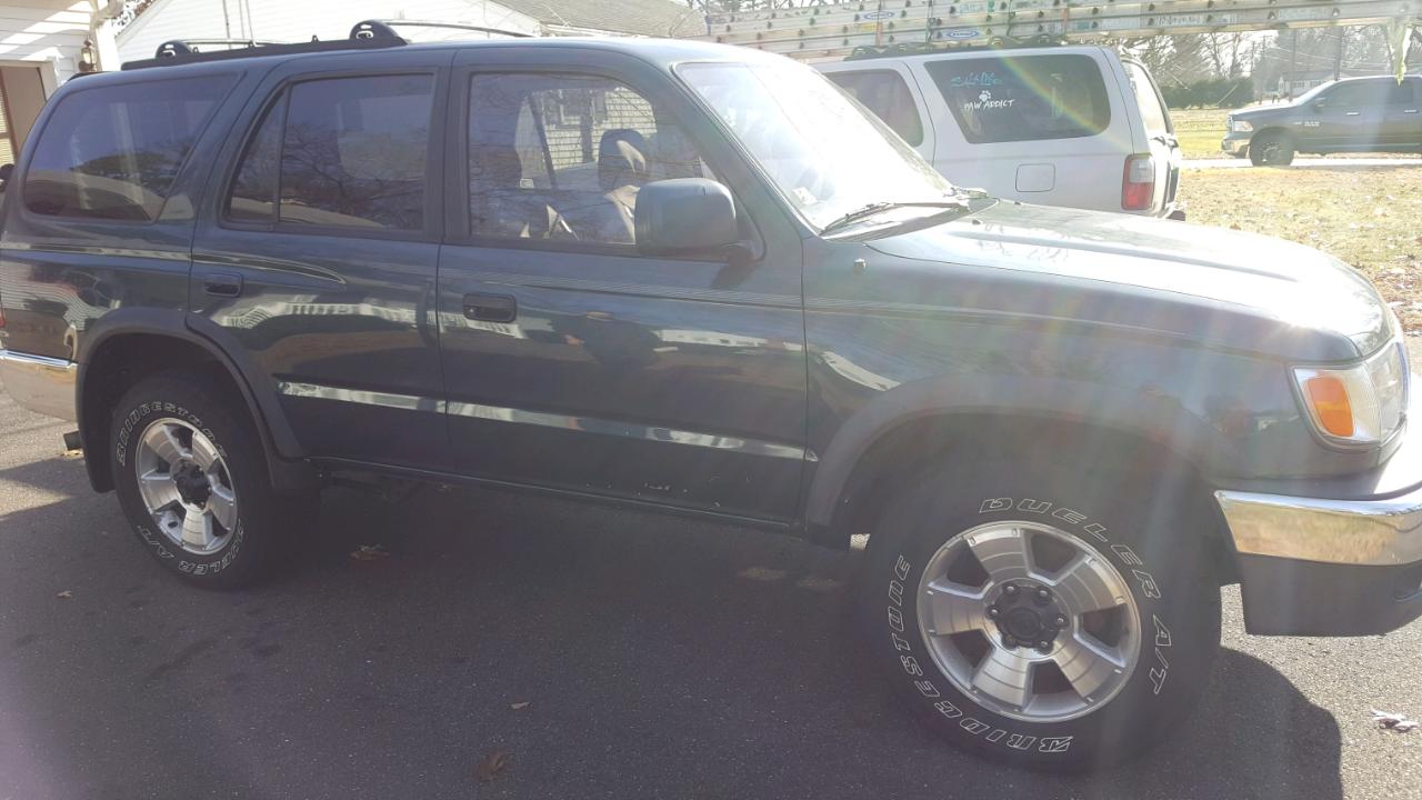

Heres something that I just came upon, I live in MA. I have a rusted out 4wd 5 speed 2000 parts rig, I'm planning to swap over the motor, 5 speed, 4wd stuff, dash and harness over to a Texas 2wd auto. I had a guy buy some parts off me in the summer, he got the southern rust free 98 2wd for $500 from a crack head. I told him Id buy it off him if he ever thought he would sell it. Just by chance I saw it for sale on FB for $1,600, I offered him $1K, he accepted. I made a deposit on it, its 2 hours from my house, I'll pick it up in a couple days. I'm very busy so just gotta find the time to Frankenstein these together.
So the 2wd frame option with keeping body is something to consider also with no salt brine patina anywhere on it.
