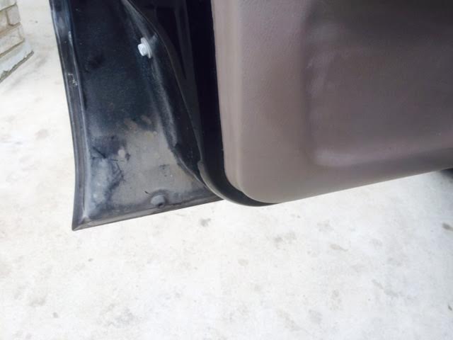

g) Proper application of wax-oil undercoating sprays - has to get into the hidden panels / main Key Success Factor (KSF).
- good example is bottom of doors (for tight seams), inside frame rails & floor pan cross members, and inside rocker &
quarter panels wheel arch lips
