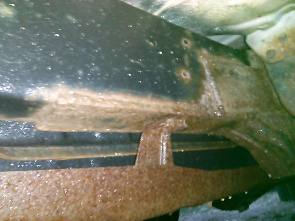

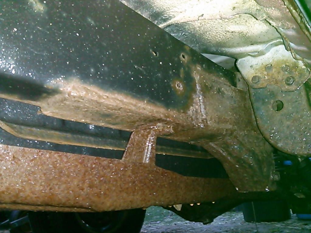

Here is a pic of my frame rail. Welded steel on both sides of rear trailing arm and underneath then welded together. Stronger than when it was new. Frames rust from inside out as well and the crap gets caught in this spot. This is the same spot my 2000 taco rusted.
