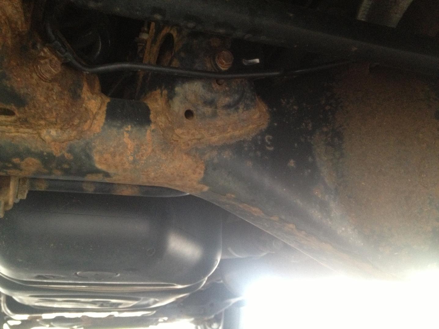

Some of you guys really don't care if your frame has rust on it? It bugs the heck out of me, especially since it is on pretty much every weld under the 4runner. Sure it is fine now, but if i just leave it, it will just keep getting worse. If toyota would have just spent a few more bucks and put another coat on there or bothered completely covering it, we wouldn't be having so many frame rust issues. Nobody should be seeing rust on their 3 month old vehicle, and nobody should be ok with it, just accepting toyotas cheapness and lazyness.

I know BOFs are prone to rusting, I just didn't think it would start so soon, especially where I live, where no salt is used the few times a year it snows. I am not by the coast, so it isn't exposed to salt air.
The parts of my frame that are rusting are the parts that the Chassis Coating didn't cover. I believe the rust came fro the exposure of those missed areas to the salty air during my 4nr's trip to the US, and maybe while it was sitting at the dock. There is a part of my frame that is missing paint, from the first and last time I let someone else put my 4nr on jack stands. That bare metal is clean.
I'm sorry, I just don't think it is too much to ask that Toyota coats the entire chassis when applying the chassis coat at the factory. If that makes me OCD, so be it.
I know this rust isn't from surface contamination that settled on the paint, and rusting on the surface. I am an amateur detailed and am pretty familiar with that.

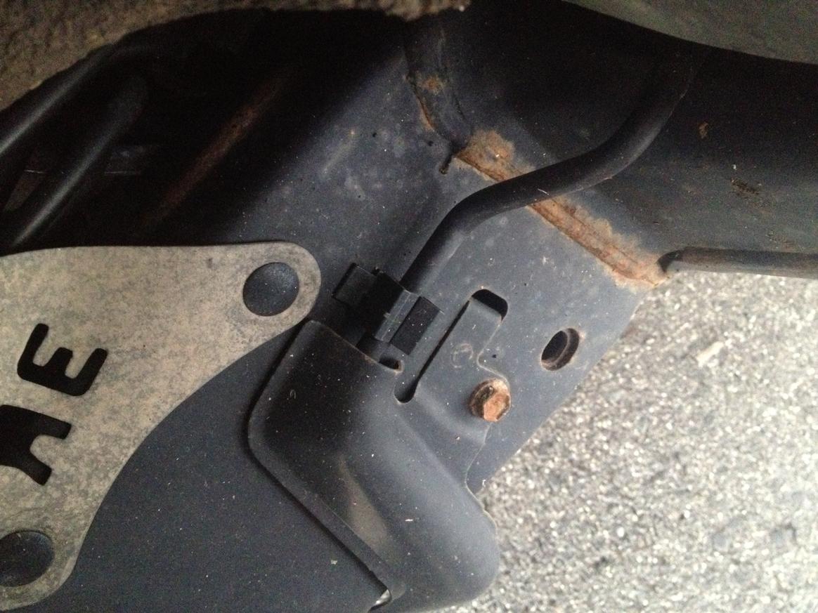

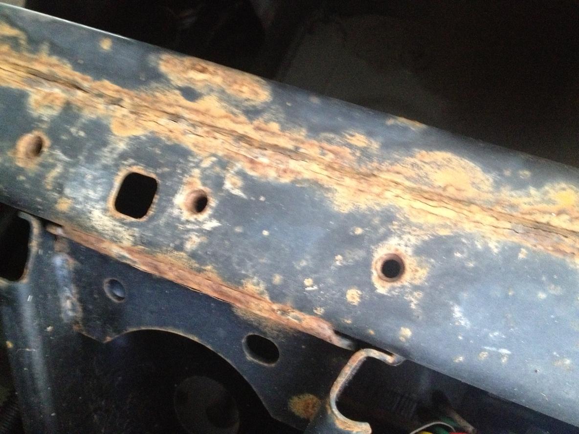

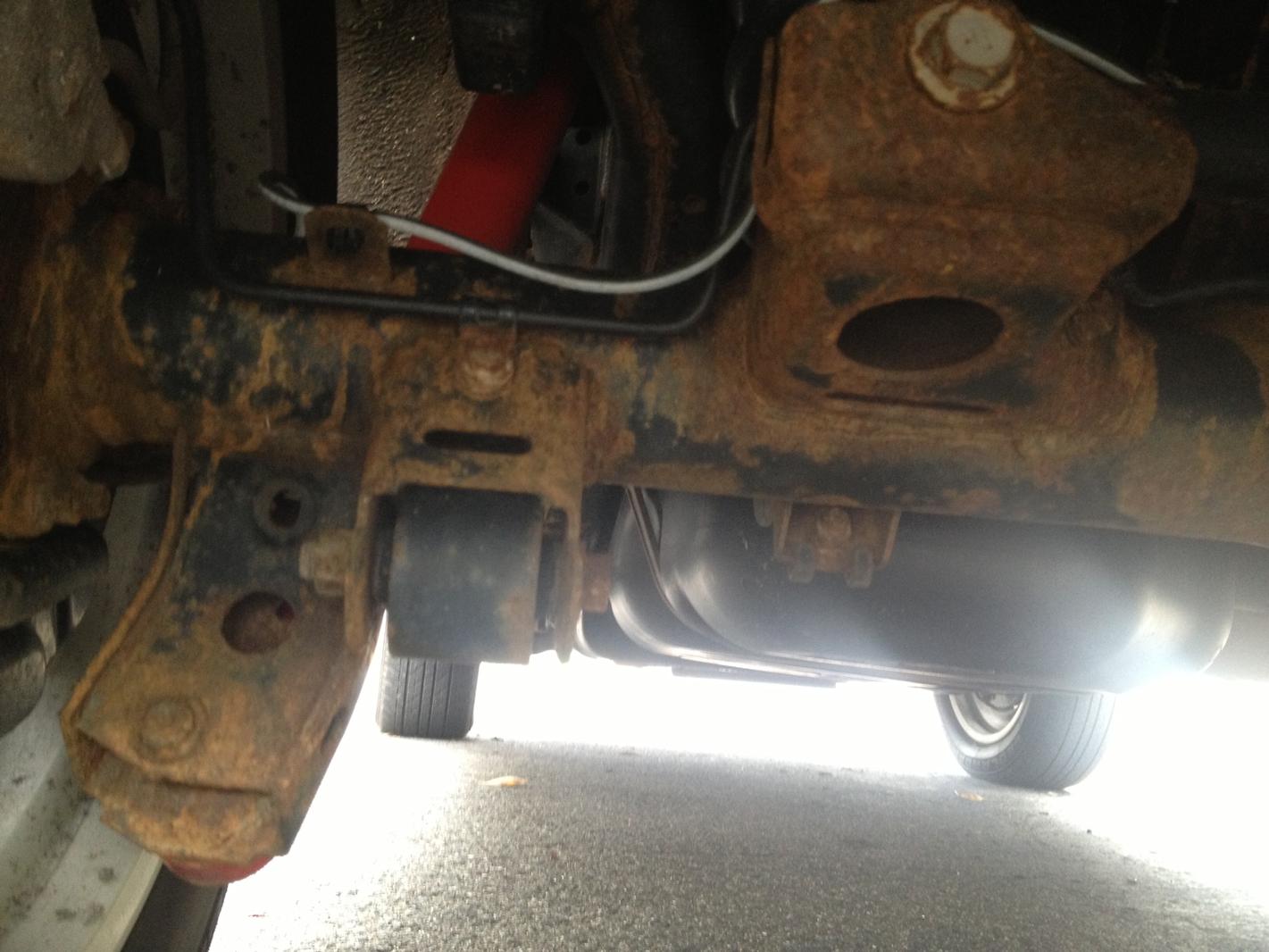

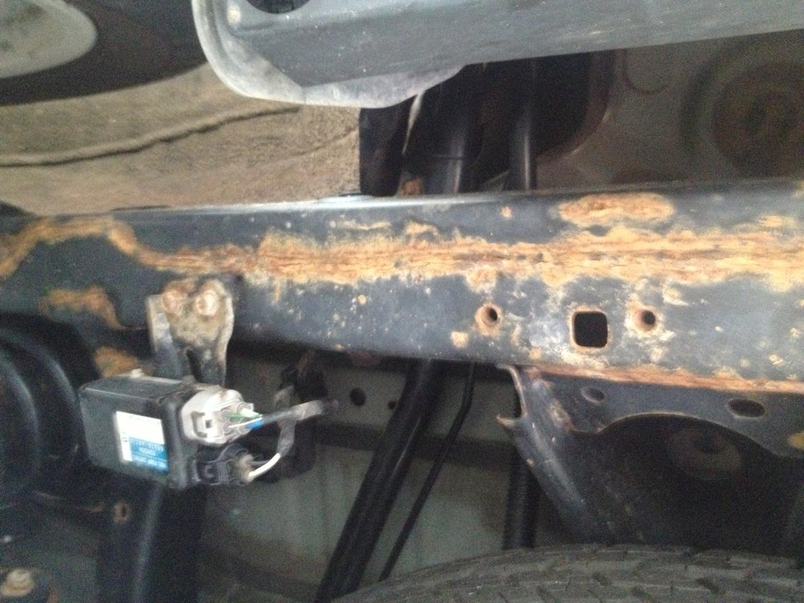

New to the forum, but I'm also having rust issue on my 2010 Limited. On my last trip to the dealer in July they noted that I was having rust issues on the under body frame (see pictures below). They recommended I take it to a body shop down the road where they install Rhino liners. After the guy at the body shop took a look at it, he said the rust issue was really only on the areas of the frame where it was welded and bolted together and suspected that they neglected to treat those areas during the manufacturing process. He said I should contact Toyota corporate. I contacted them, they sent me back to dealer where the head of the service department took some pictures of the frame and later discussed it with the regional service head. They said there was nothing they could do about it and recommended I treat it with POR-15. I'm pretty pissed off that a truck under 3yrs old and 30K miles would develop this type of a rust issue. I'm going to keep after it with Toyota corporate but wonder if anyone can provide some insight/recommendations.
Thanks,

I recently painted most of the rusting frame welds on my 2010. Seems like a fairly easy and cheap fix. I may have to touch it up now and then but it should do the trick. However, the rusting I had was just along the weld lines and no where as bad as yours.

Out of curiosity, do you rinse off your under carriage as soon as practical, after driving in the snow with all that road salt? I know it's not always possible due to the weather, but i try to give the under carriage a good rinse after I've driven out on the salted roads.
That's just not possible for me.
If I lived in a area where salt was being used in the winter and bought a new car. I would immediately put it on a lift and spray 4 bottles or so of 3M under coating under neath everything metal. Pretty easy to do when the car is new and has a clean under body.

Welcome to the joy and agony of owning a 4runner. Painting over the rust is like painting over cancer. I have a 2000 SR5 that I tried painting over the rust, and the frame just rusted from the inside out, and only has 120k on it. Oh what a feeling! I was hoping that this was going to be a 20+ year vehicle, instead I had to take it off the road, and now have to drive my 91 Suburban instead; go figure. It looks like Toyota Japan does not produce a superior product anymore, or feels that they have no obligation to their baka gaijin customers. Sorry to say this because I really liked my 4runner, but the best thing you can do is to sell yours since you are facing inevitable catastrophic frame failure.
This is a common issue. I went under my 4Runner when it was less than one week old. Just off the dealers lot and mine looked very similar. It was in June and hit the dealers lot a month or so before so no Iowa winters yet. I thought about worrying about it but have other things to worry about in my life. It is now getting a dandy of an Iowa winter and I have taken it through the touch free car wash three times and put another coat of wax on it. I will give it really good underbody wash as time allows plus the car wash does a fairly good job. Keep it clean by washing it and if it gets worse talk to the dealer about it. You can literally eat a steak dinner on the undercarriage of my Bonneville after 9 Iowa winters and all I did was wash it out well a few times every winter.
