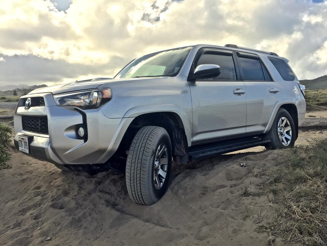

I bought this 4Runner from a dealer in 2016 with only 628 miles. I must mention this is the newest car I've ever owned since I always buy used.

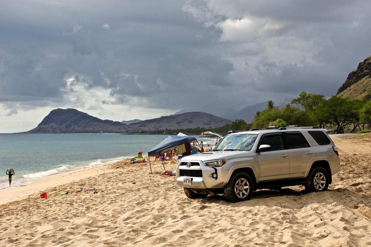

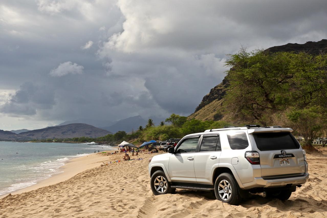

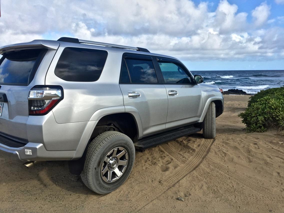

Right away i took it the closest beach access to test the 4x4 and I must say it handled the soft sand like a dream. The stock tires just floated over the sand and I never had to air down. It actually surprised me how well it handled since I've always had a lift and bigger/wider tires on my previous Toyotas. Sorry for the overly filtered/saturated images as I was in HDR mode back then thinking everything looked better that way :confused: Last pic is how it currently looks.

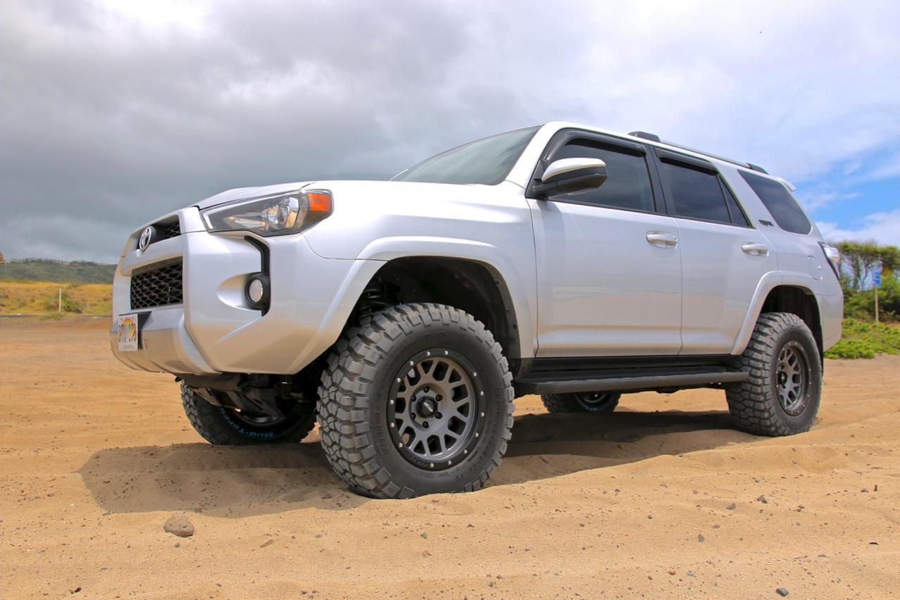

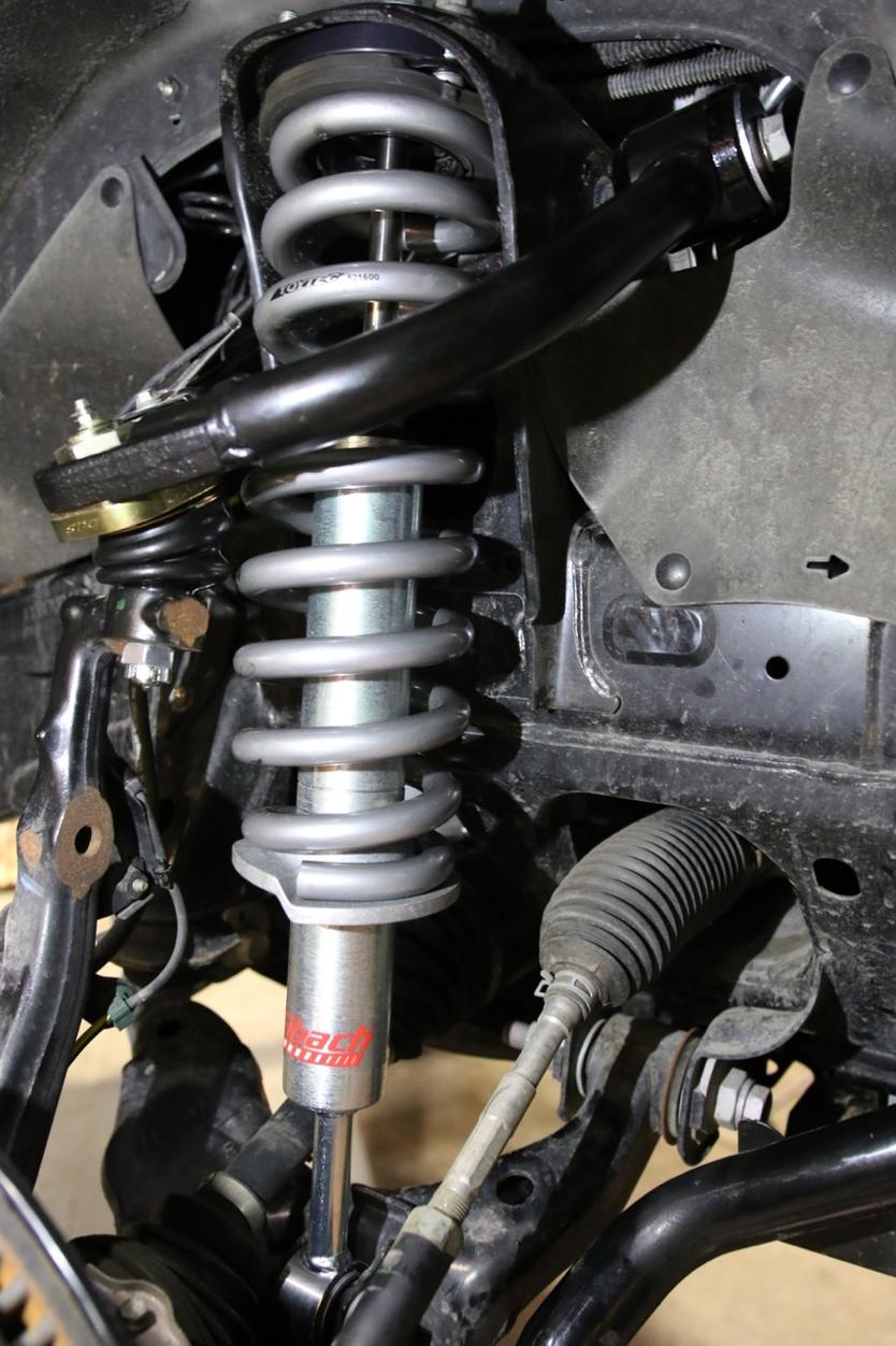

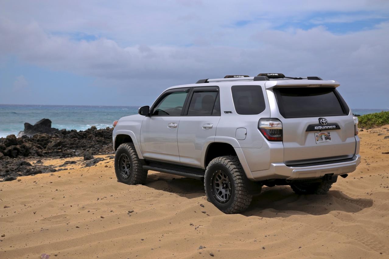

1st immediate mod was lift and tires. I got sponsored by Eibach and SPC to use their parts on my YouTube channel under the truck build section. I did not get a wheel/tire sponsor but do have a dealer account with 4WheelParts so it made it a little bit cheaper than full retail (If any of you guys are on Oahu, I can get you a better deal as well). Went with 285/70R17 KM2 on ProComp 17x9 Vertigo Wheels. Here is the video we did:

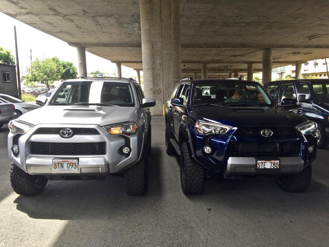

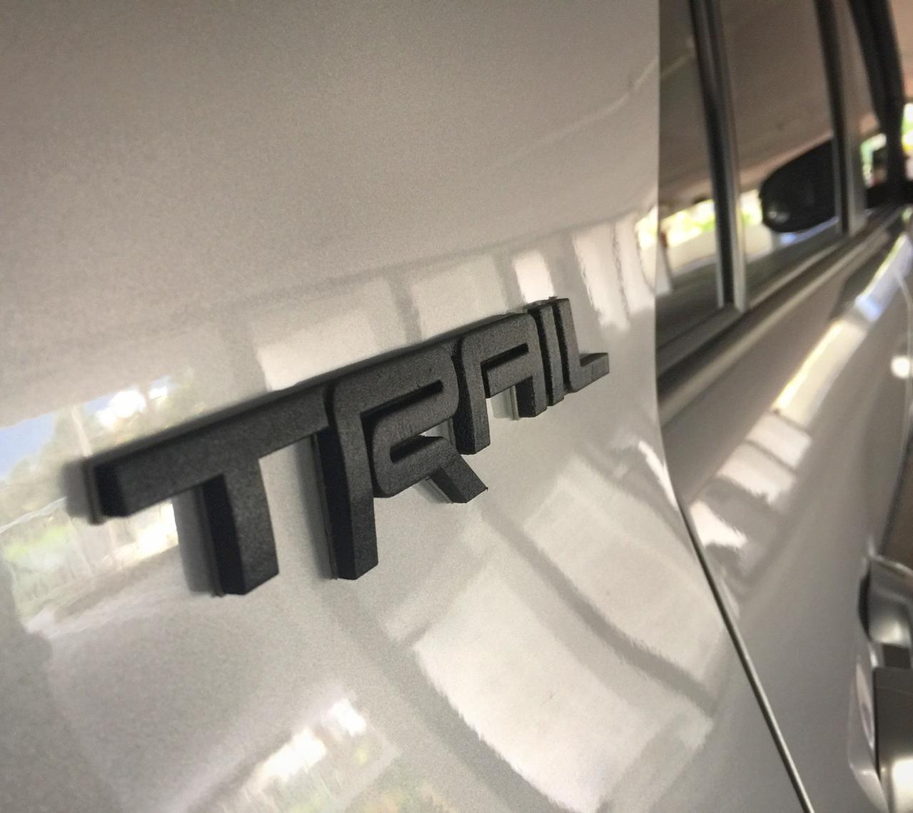

A few pics from around Oahu. The 1st one next to blue Trail is getting my Recon sticker. I really like that rare color.

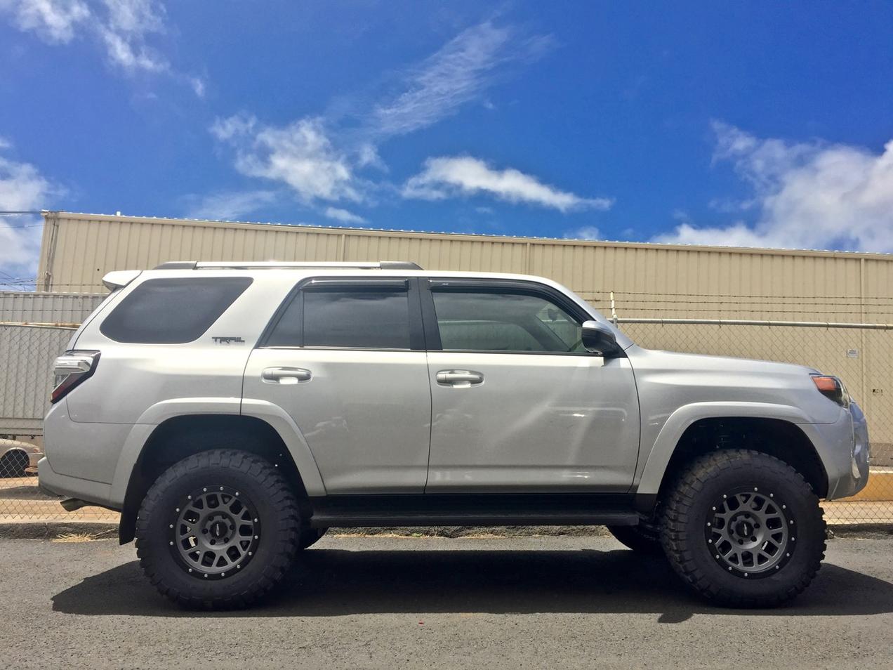

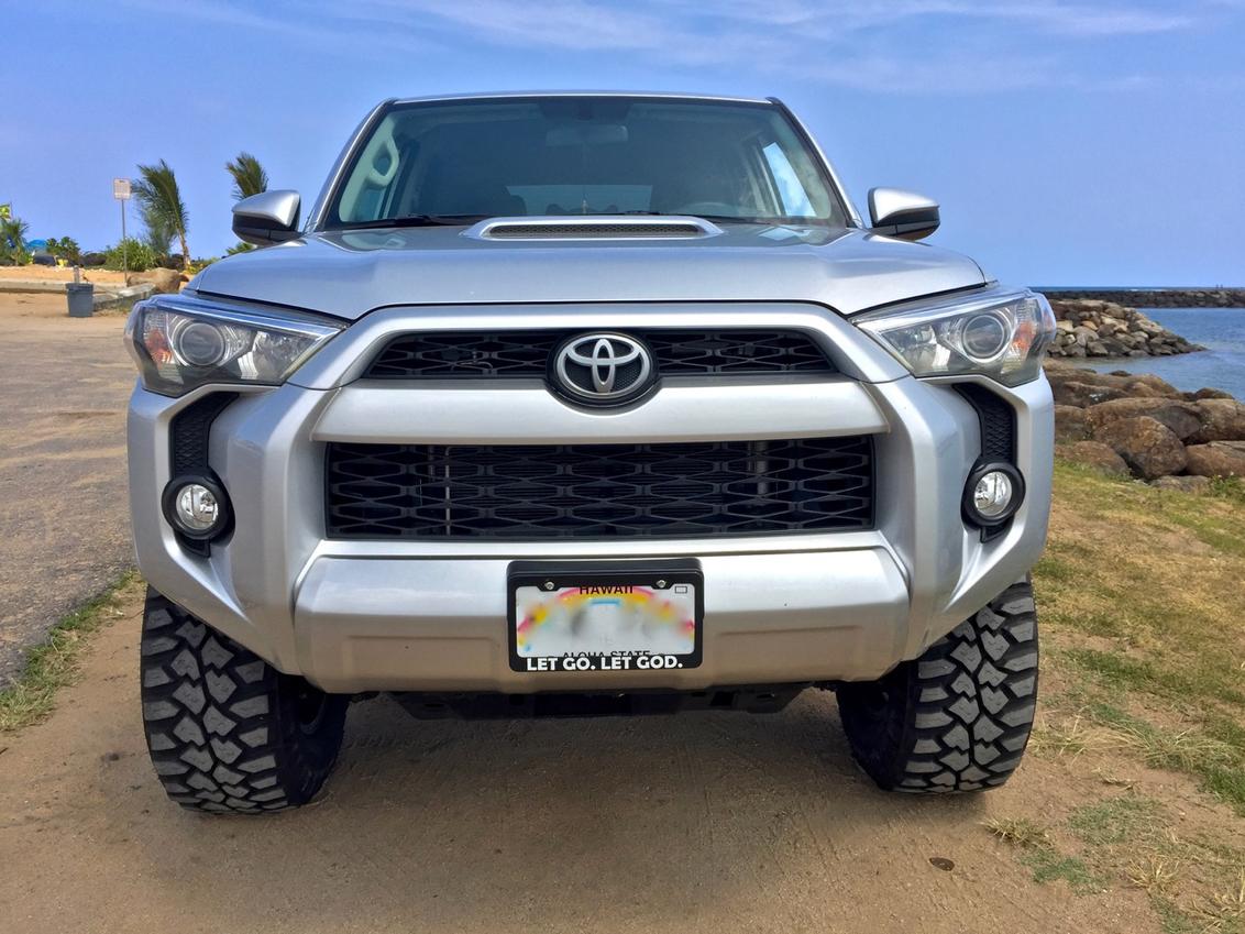

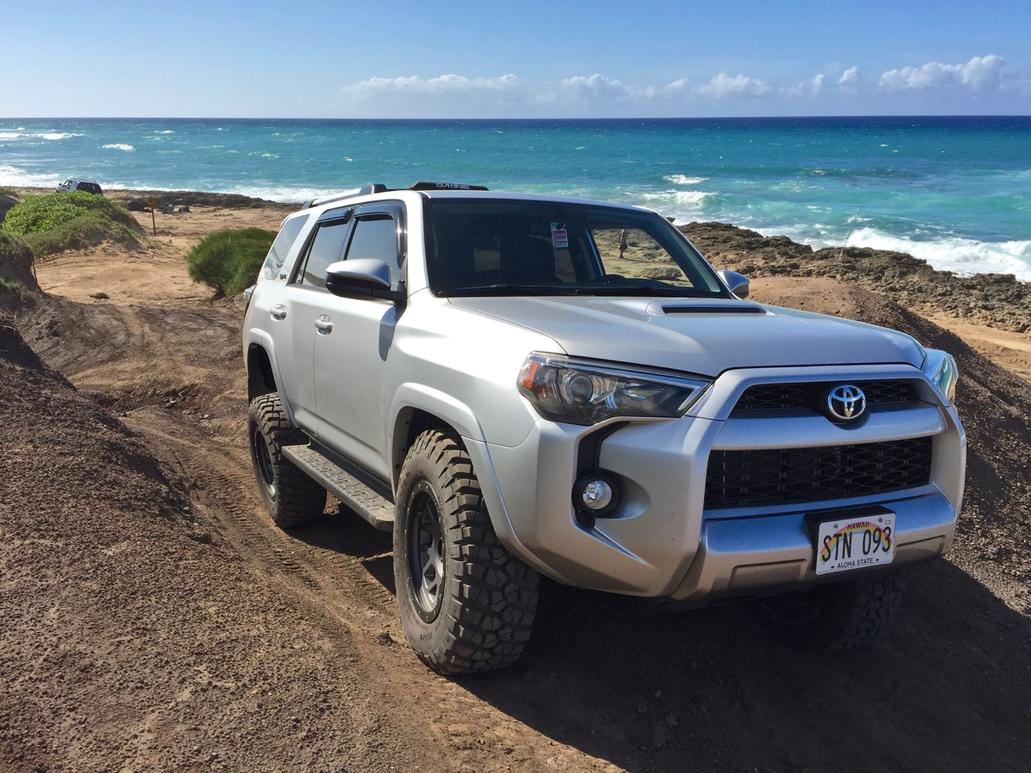

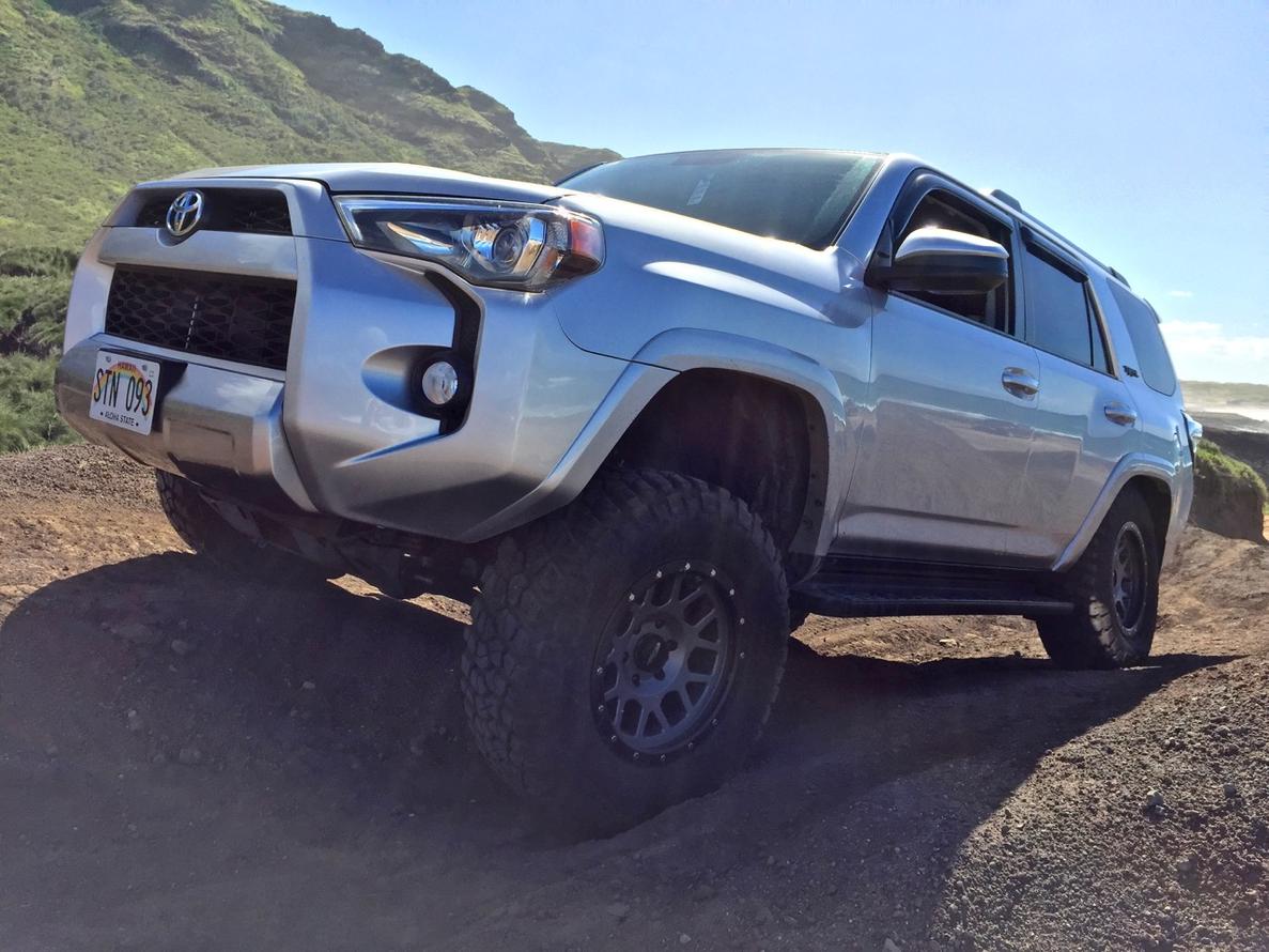

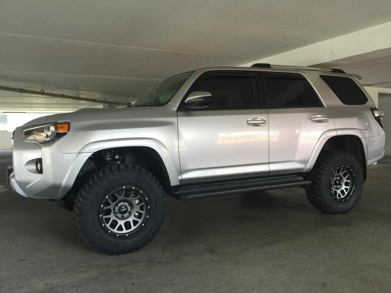

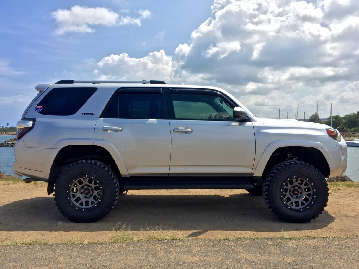

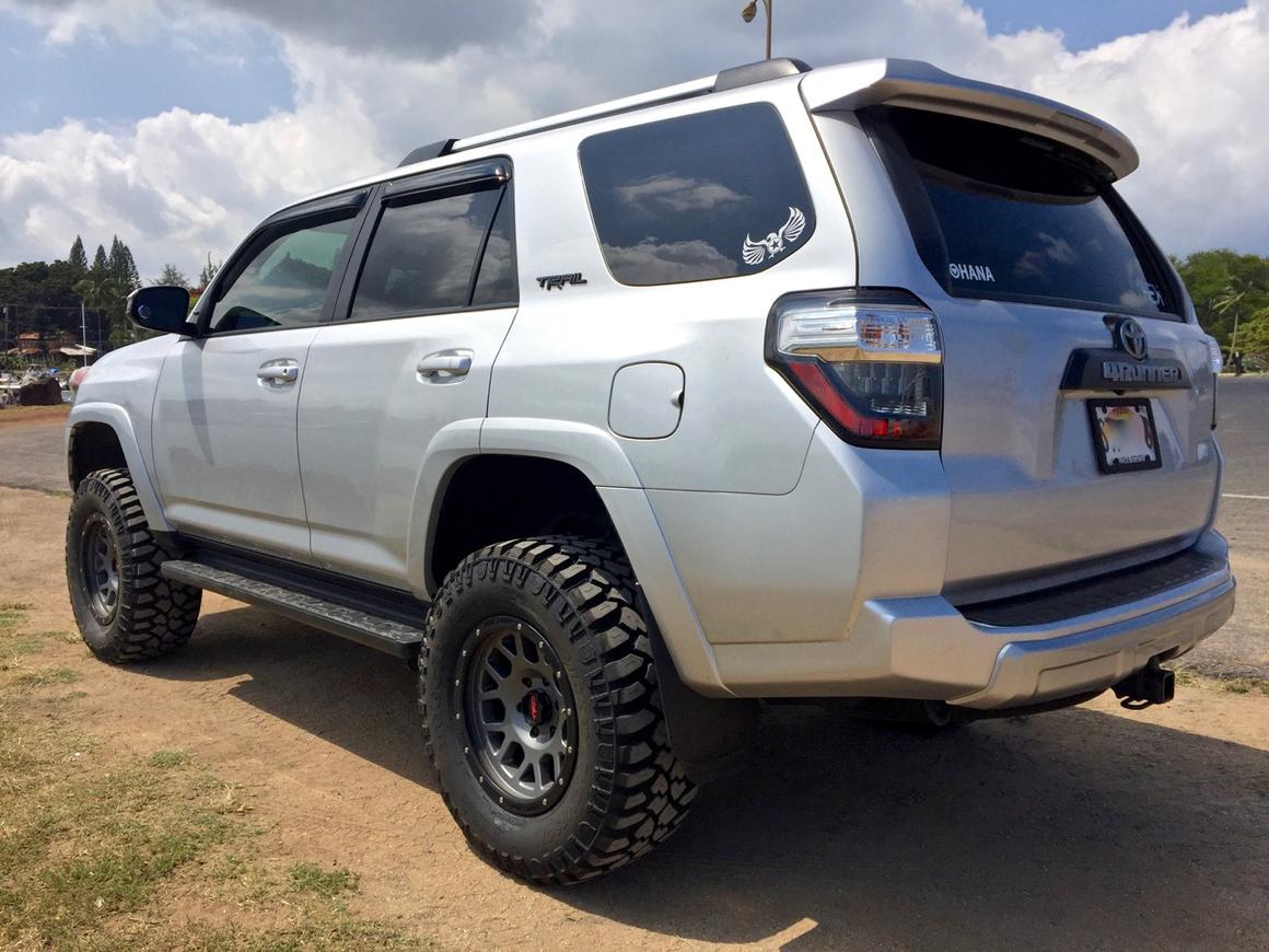

Really liked the KM2 setup for a while but kept seeing guys running 12.5 wide tires and decided I wanted to go that route. Plus I find it's better to sell/switch tires out with at least 50% or more tread left that way you can get some cash back out of them vs not. Decided on the Mickey Thompson Deegan 38s in 305/65R17 because they're the lightest in weight in that size and less dense E rated compound (2 ply). No company makes C nor D in that size for 17s.

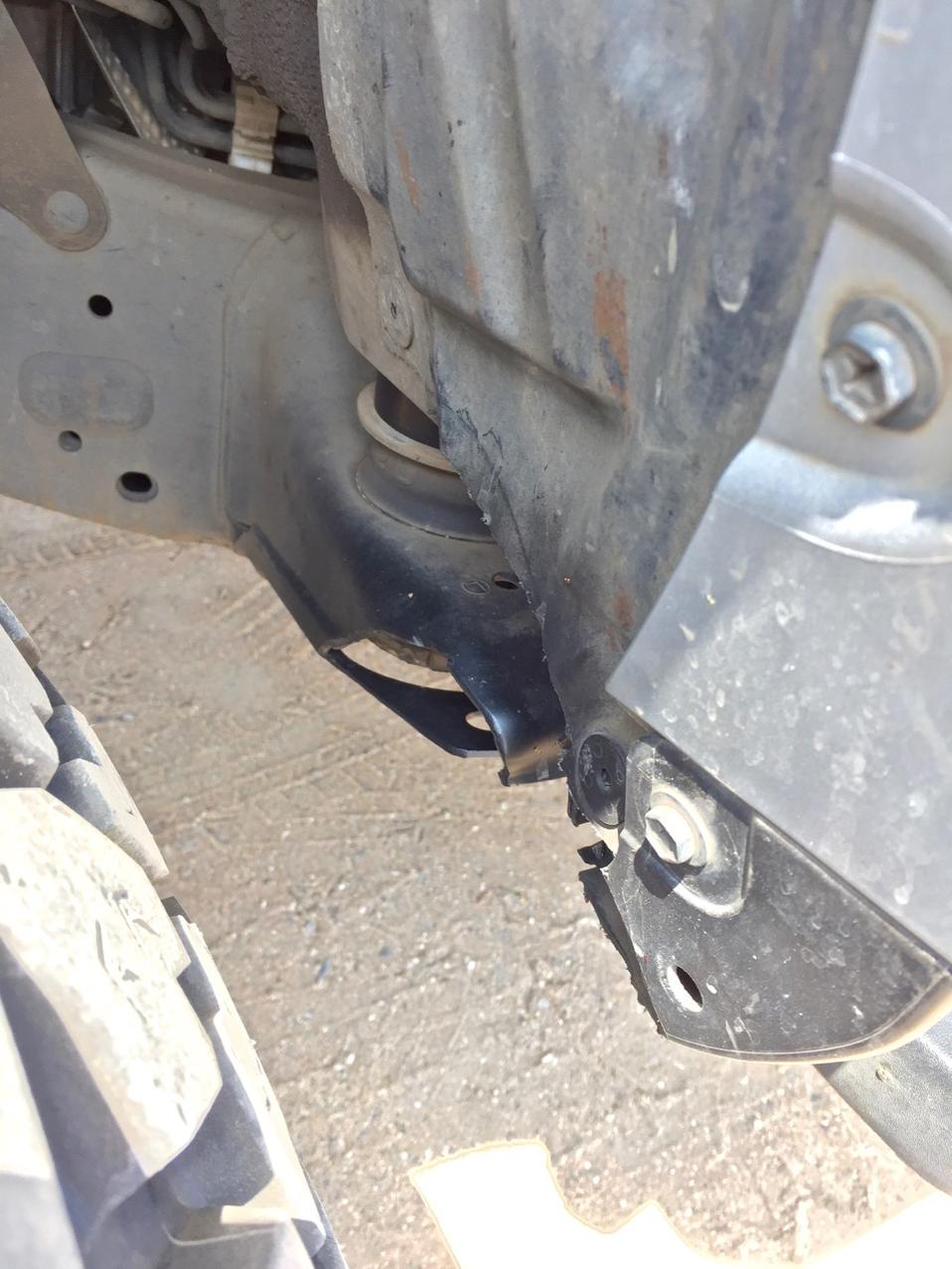

It definitely took a little fender flare trimming and the BMC to clear this size but love the stance. The ride quality was a bit stiffer than the KM2 since they're E vs D rated as well as the MPG dropped from 17 to 15-16.

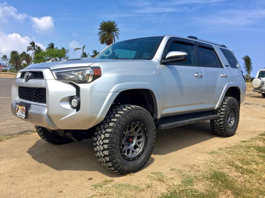

Shortly after that, I installed Fat Pats 1" body lift to help further the wider tires. This took about 5 full hours of trial and error to do but am happy I did in the long run. I have another thread here with details & pics:
http://www.toyota-4runner.org/5th-gen-t4rs/236913-installed-1-body-lift.html
Here are post 1" body lift pics. One showing the fender trimming & BMC:

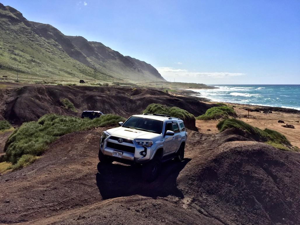

A video and a few pics from a drone shoot I did at Kaena Point, Oahu with a couple other 4Runners and a Taco
