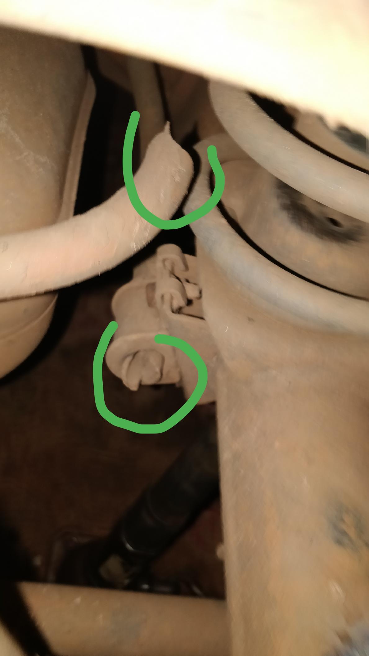

So, recently observed my rear sway is broken yet again, i dont wheel, though go offroad infrequently to exercise the 4wd, i have rancho quick lift struts with 1.75inch lift at the front, and 1.5inch lifts at the rears.
am puzzled at the frequent breakage, so my questions are
1. Could i weld the broken sway bar and reuse?
2. Are there beefier sway bars i cud install, as i noticed the sway bar is just a hollow metal tube
3. If the above 2 scenarios are wrong - ie would transfer the stress to the next weaker link. what is the next weaker link that this stress would be transferred to???
4. I am not comfortable running without rear sway bars, cos i pulled off/broke one of my rear brake lines last time, due to too much articulation -

so would try the option of using 2nd gen endlinks. am thinking of welding the broken sway bar and use it with the 2nd gen end links for a while, lemme see how it holds up
