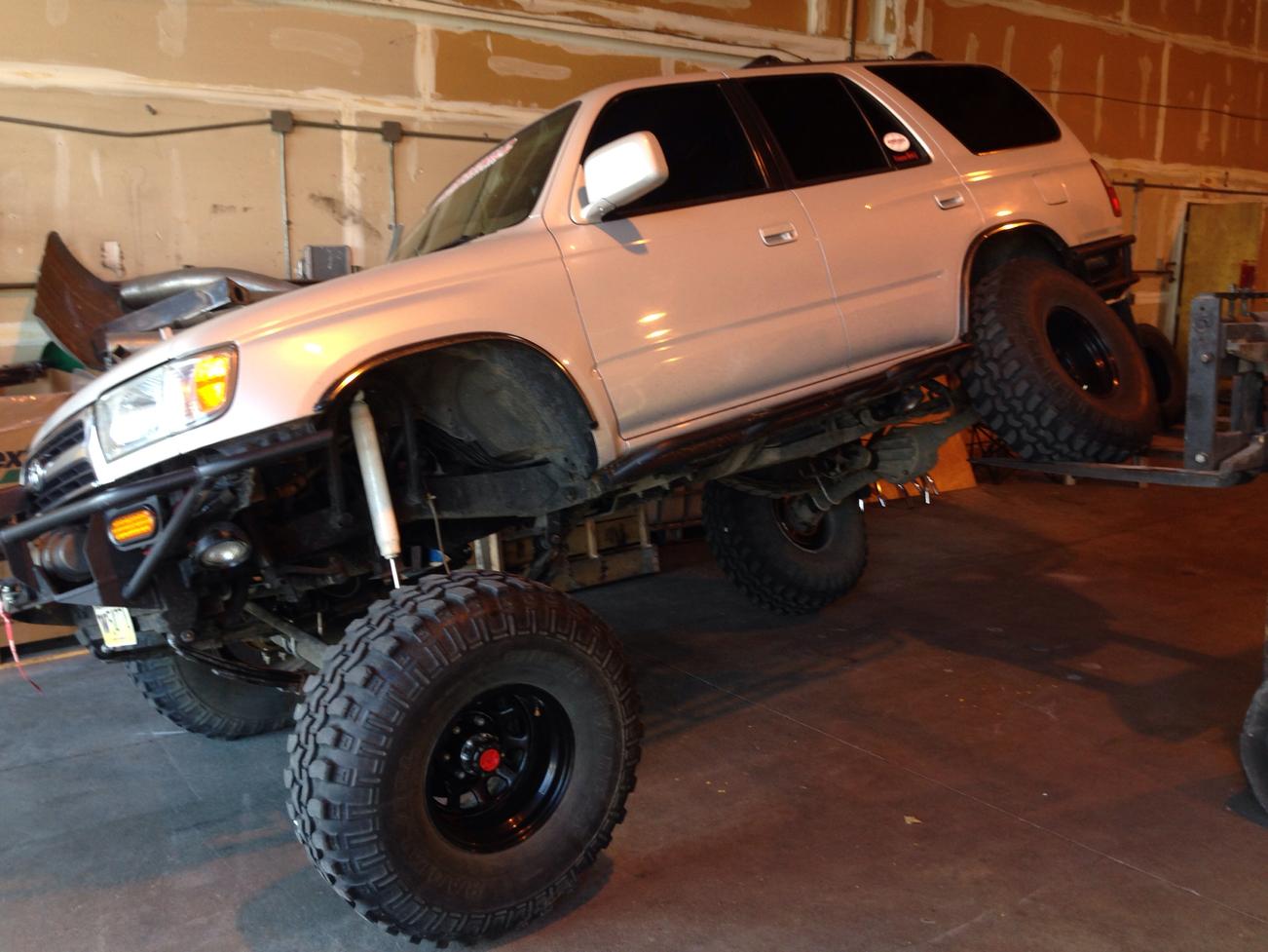

I agree with 92-SR5. Trail gear springs will do you good. Not to say ruf's and 63"inchers won't flex like crazy, but trail gears springs are actually pretty damn flexy even when new. And it'll take a lot of the guess work out of piecing together spring packs to match front and rear. This is my 3rd gen on brand new 5" trail gears the first day I drove it out of my shop. Too tall for my taste but I'm planning on running 39.5's so I'm gonna leave it alone for now but I'm seriously considering getting a set of 3" if I decide not to link my rig.
