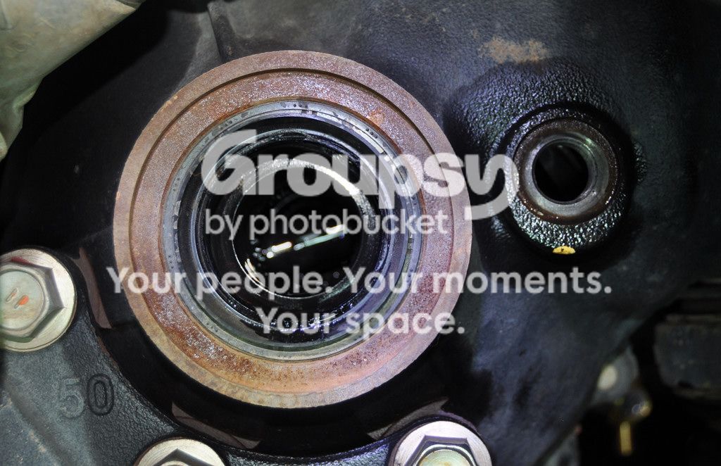

Here is what the drivers side seal on the diff looks like as I snapped a pic when I had my CV axles out.
CopyofPicture050-1.jpg~original
And here is Chase explaining the play at the cv axle and a possible cause for the drivers side leaks. Toyota still uses this exact same front 8" clamshell diff on ours and on many Toyota trucks for years.
