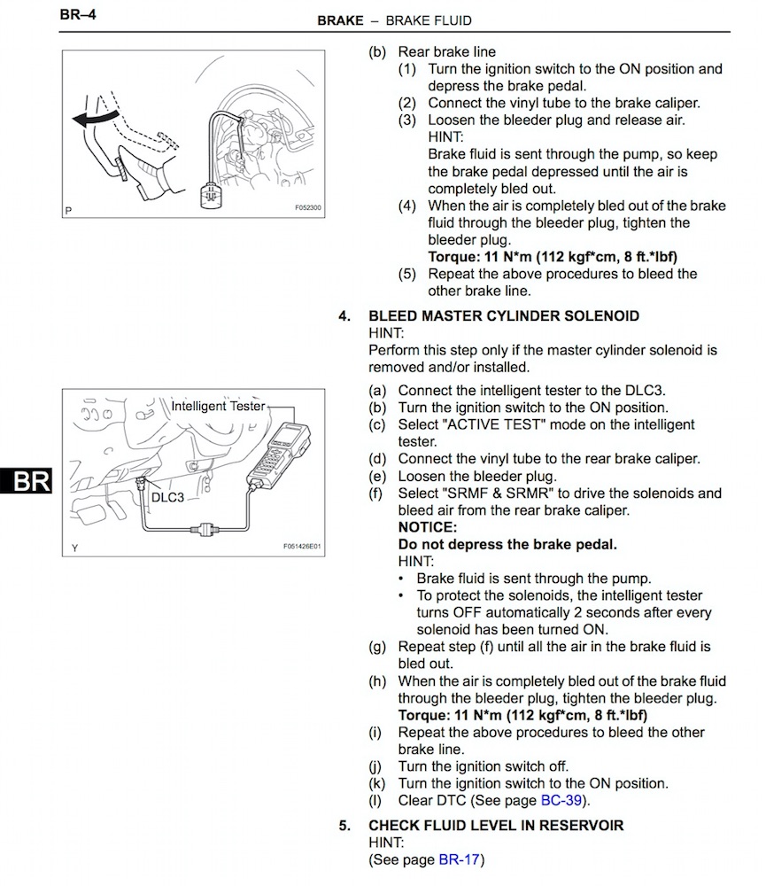

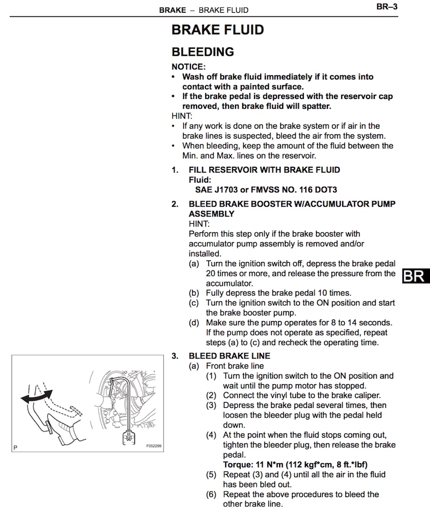

Here is the toyota brake bleeding info:
View attachment brakebleeding.pdf
Do the lines all at the same time as the calipers because you'll have to bleed it all at the same time. Fronts must be bled with vacuum bleeder or pumping pedal the normal way, rears can be bled with just holding the pedal down and cracking the bleeder valve since there's a pump that does the work for you! Don't let the reservoir go dry whatever you do! You'll need a big bottle of fluid for this job. Hard lines have union nuts, do yourself a favor and get a proper 10mm union nut wrench. If they don't break loose you can apply heat and PB blaster to carefully work them loose, if they are rusted better to replace since the pain you've caused with heat and wrenching will only weaken them more. My michigan raised 4runner had all good hard lines still at 115k miles though so you might be fine. I just torque them til their tight? They are a tapered seat type fitting so tight enough to not leak works, too tight and you'll just mash them together more creating no better seal and making it harder to remove next time. Brake line clips can suck, I like to use a flathead screwdriver to pry them out a little bit from their mount then grip next to the tab on the very end with a big needle nose pliers and again use those to pry off the mount tab. Probably not a good visual description but try it and you'll see what works best, they can be a pain. Good luck!
