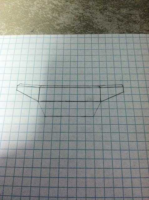

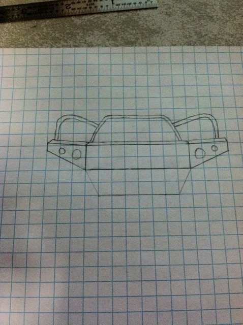

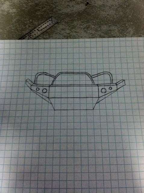

I'm starting out with a drawing on paper that I hand drew using a couple of plate bumpers I've seen online as a "guide" to what I want mine to look like.

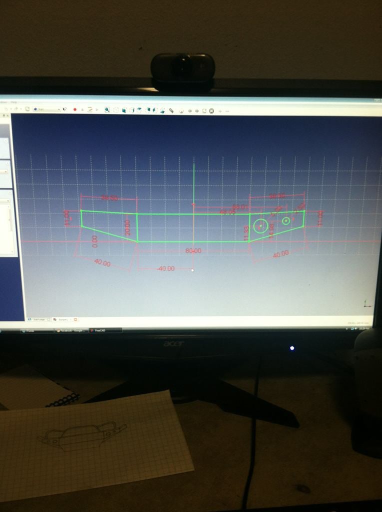

Next, I downloaded FreeCAD, and just been messing around with it to get a feel for what the final product will look like. All I have so far is just the front plate with the right light holes. CAD programs are so wonderful with how easy they make designing parts! I'll soon be using SolidWorks to make the final product.

Maybe it's the image, but you will want the top to be flat; it looks like the sides of your bumper angle up and you'll never get it to fit. I.e., the bottom of the grill, headlight filler pieces, and fenders are all in the same plane.
3/4" anything except recovery points is way too thick. I think everything on mine is 3/16" or 1/8" (recovery points are 1/2" with face welds)
Ya, the top is flat, I'm just not the greatest artist in the world. Same with the sides, they're flat. And thanks for the tip on the thickness of the steel!

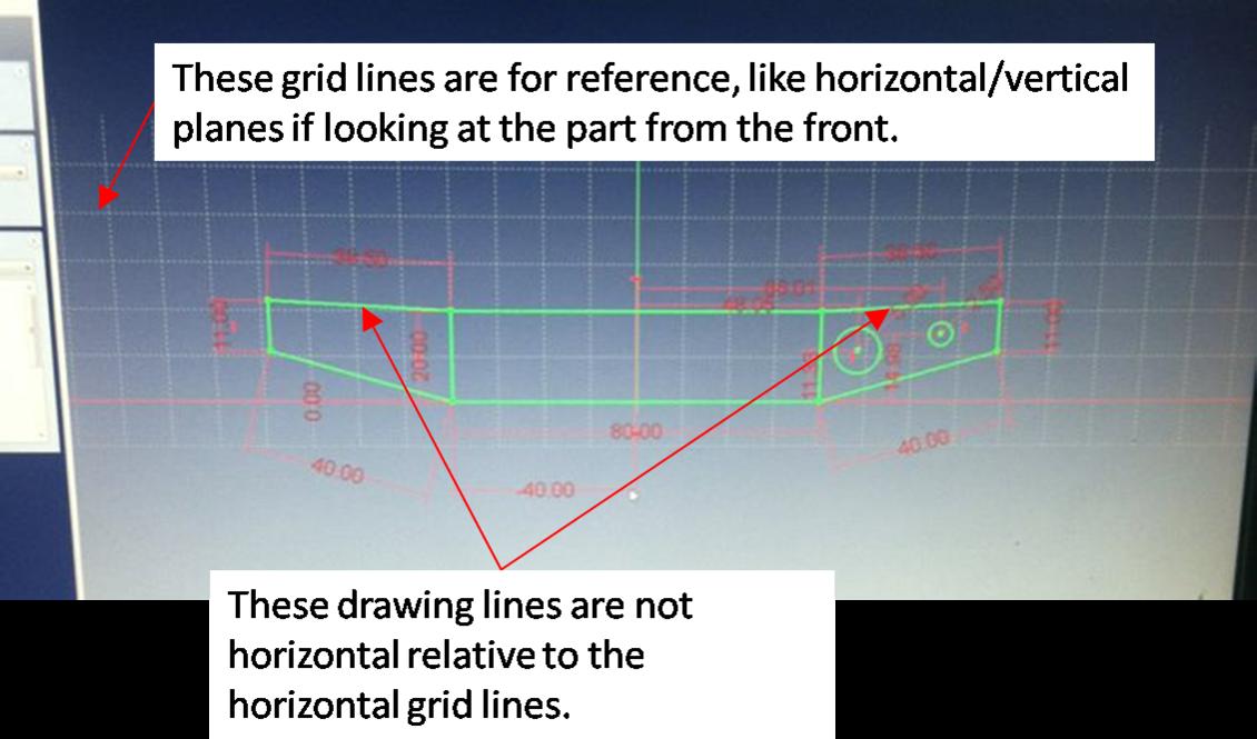

It was the CAD pic you took that my comment was based off of... if that's a front view, then it's not flat on top.
also, pro-tip: screen shots (ctrl+print screen then pasted into paint or powerpoint or similar) is a great way to share CAD work. CAD is an awesome tool though and can definitely be a valuable one in your professional life!
I'm totally new to CAD programs. Can you explain to me how that drawing would make the top at an angle and not flat?
This may help... it's important to always be thinking in 3D. What program are you using for this drawing? Do you have solid works access? That is by far the best and easiest software - Pro/Engineer or Creo is anothe popular solid modeling package, but it sucks at best. I hate it.

Looks good! My only suggestion is to maybe change up the hoop design. If you're going custom build, you might as well do something unique as opposed to something that is already out there.
Looks awesome. I'm working on a very similar design right now (love those hoops)...still at the drawing stage though haha. I'll be able to use my school's machine shop to cut pieces/bend tube and my friend will help me weld it up.
