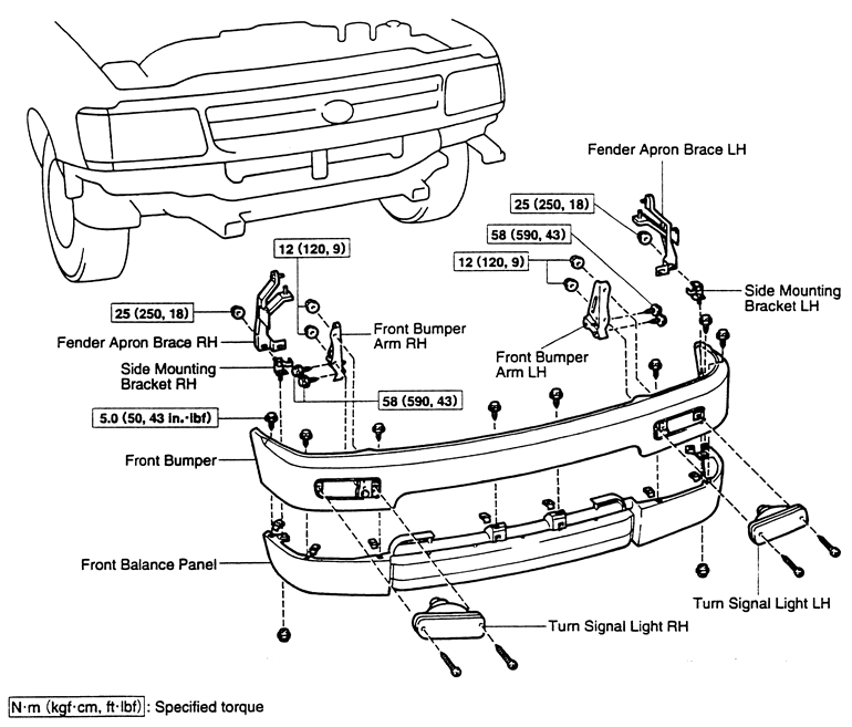

I havent searched for bumper replacement pics myself, but if there arent any it will be because its do damn simple to do! Just unclip the turn signals and unbolt the bumper. Thats it.
