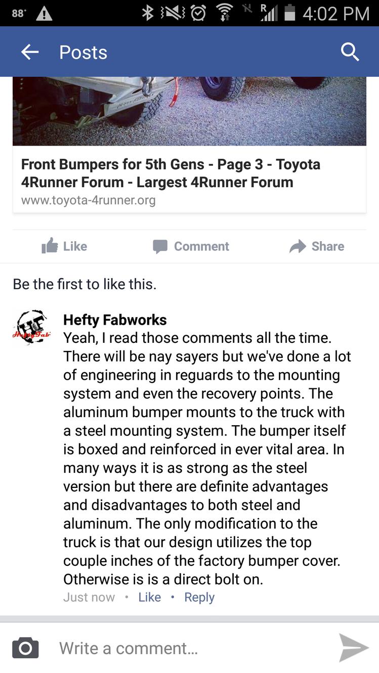

Response from Chris about aluminum bumpers uploadfromtaptalk1442610244688.jpg

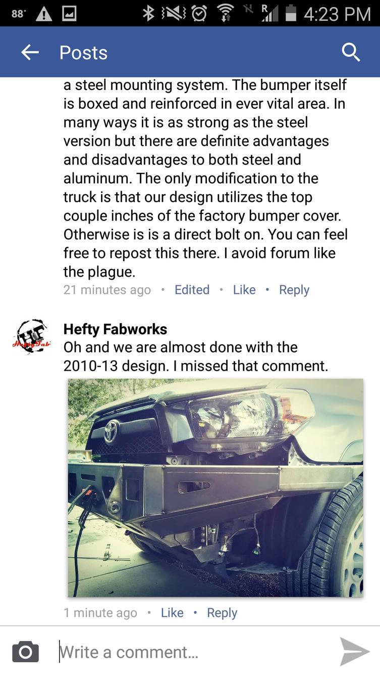

He said he's also nearly done with 2010 to 2013 bumpersuploadfromtaptalk1442611502966.jpg

For what it's worth, I understand the aluminum versions are more for looks and weight reduction. They'll provide much more protection than the stock plastic bumper, are much lighter than steel (milage!), and are more than adequate for a mall crawler or someone who only offroads a few times a year and doesn't try to get stuck.
But if you're into serious regular off-roading, especially if it involves rocks, go with steel. Aluminum has poor fatigue resistance (repeated stress), poor fracture toughness (ability to resist rupturing with impact forces) and poor abrasion resistance (scraping on rocks). And your typical weld shop can't repair it.
Everything has a purpose. Even aluminum bumpers and skid plates.
