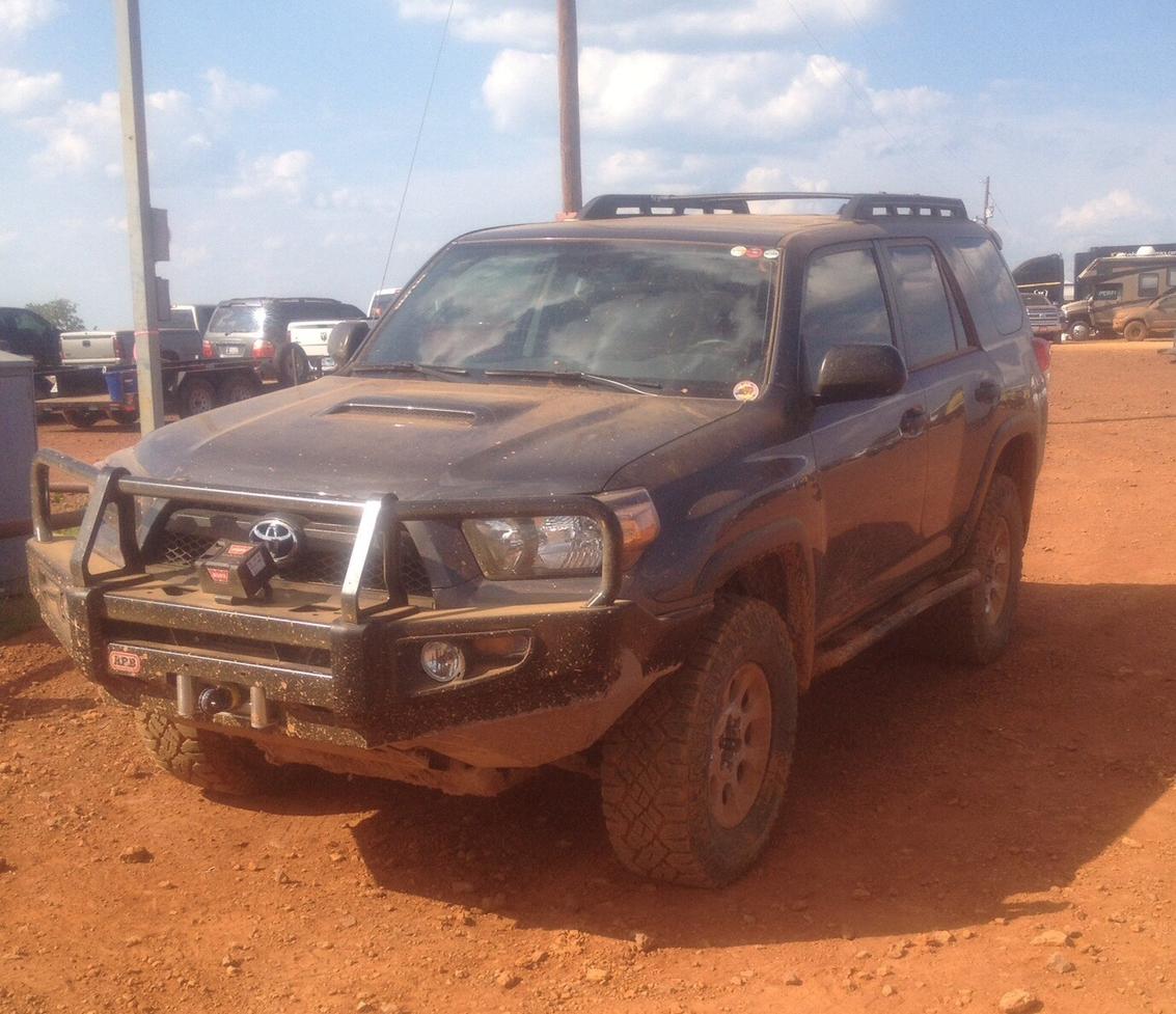

There are enough pics of my 4Runner around as it is. I know there are a couple others with ARB bumpers that look pretty badass too.
It's definitely not as "huge" in person, however it hangs off of the front more so than the Shrockworks and for sure the 4xLabs model. I love the ARB so each his own.

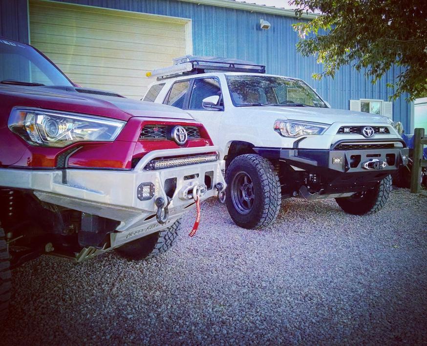

Does this provide the coverage you need? I really like these and will hopefully head down to see them in person when I pick up my aluminum skids Chris is building for me. I am so close to putting my down payment down...more pics on Hefty Fab's facebook page.

I'm surprised everyone is so eager to jump on the Aluminum bandwagon here when there isn't proper engineering being done on these bumpers.
neither Hefty nor Pelfrybilt have addressed the fact that they use aluminum in their D-shackle mounts, or that there is no steel super structure behind the aluminum shell.
its all fine and dandy to use aluminum, i support it whole heartedly - as a shell. aluminums number of stress cycles it can endure is severely limited compared to steel. people that regularly use their front shackles for recovery or put their vehicles in heavy articulation frequently will eventually see stress fractures. not to mention, the sheer strength of non-aircraft grade aluminum like these bumpers are made from is no where near adequate for angled recovery or the use of snatchblocks.
thats great that they're pioneering the 4Runner market for aluminum, but without a steel superstructure underneath that serves as a front crossmember, winch plate and recovery point - these bumpers have a shelf life.
It'll cover up most of it, and I really like the look, but they don't have a 2011 version yet :(
Actually Hefty does address it...they make the bumper in steel as well! :nod:
Not sure what you mean? Having options for their customers is a good thing.
Not every customer has the same plan for their rig...just like not every T4r member wheels heavily or often.
