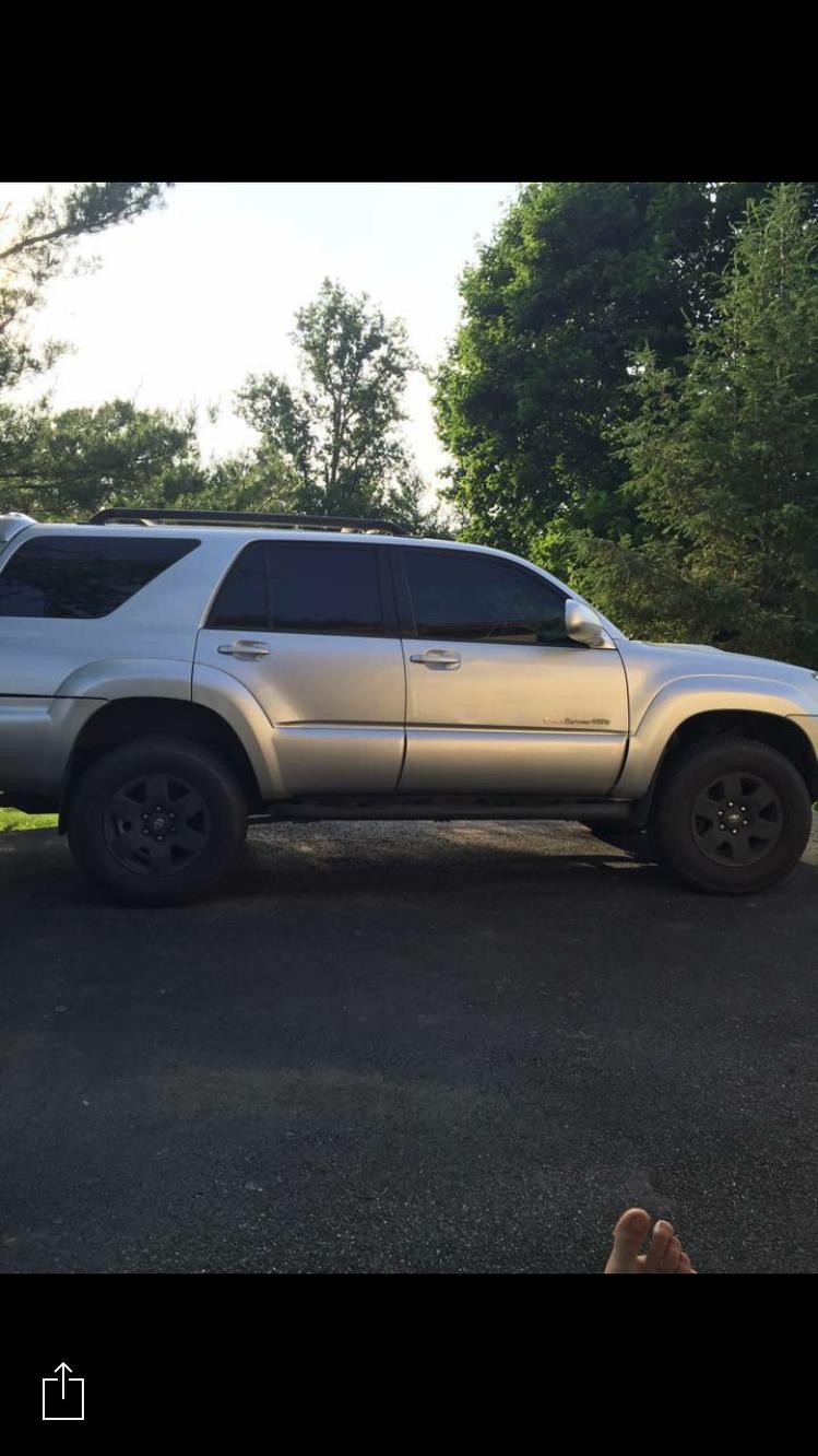

Have a 2007 sport I believe I have a 3/2 spacer kit(was on car when I purchased) front still is a little lower. Is this a front cool sag problem or is this normal? Car has 123k on it. What are some good replacements that people have used that aren't too pricey

That looks pretty normal as the 4th gens have a standard 2"ish rake. My 2004 with 112,000 sits pretty much like your does and has the spacer/leveling kit as well. I'm replacing my suspension with OME/Toytec (for just under a grand) this Saturday as one of my front struts is leaking and I'm starting to get a "little" bouncy in the rear. Most find that the rear on T4R's droop or sag.
You can get some fj coils to freshen up the coils for cheap. find them used or buy new Moog ones on RockAuto.
So honestly how do i tell if that's just normal or it's the front coils sagging. If it helps at all my 265/70/17 tires are rubbing my control arms which I don't think is normal since that's pretty close to being a stock tire. Like I said bought the car like this but want to get it as level as possible. I also have xreas suspension so I know that limits my options.
