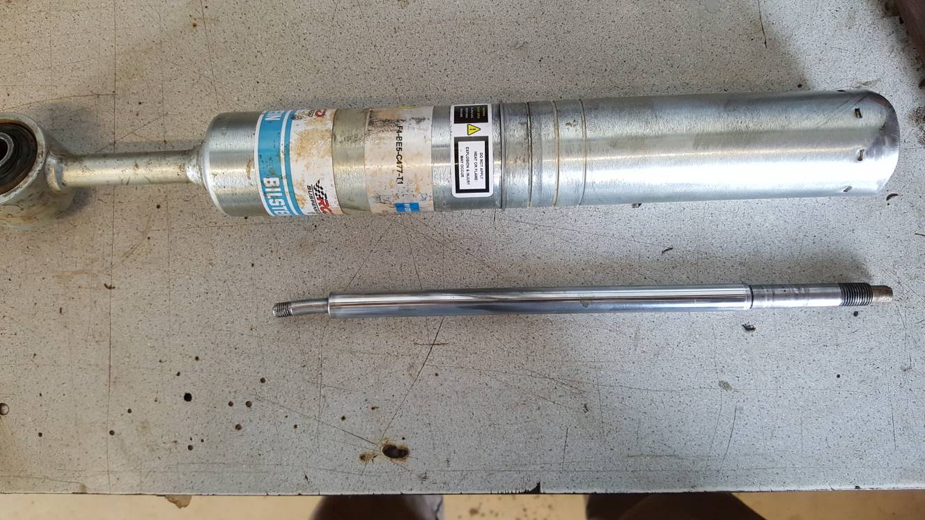

I have had these Toytec Ultimate coilovers for 6k miles. It started leaking at 4k on a 2k mile trip and bent/broke along the way. They have already sent a replacement strut but I am not comfortable using these. Radflo, Icon, Fox, King? I also want to swap arms while it is tore down if anyone has a recommendation.

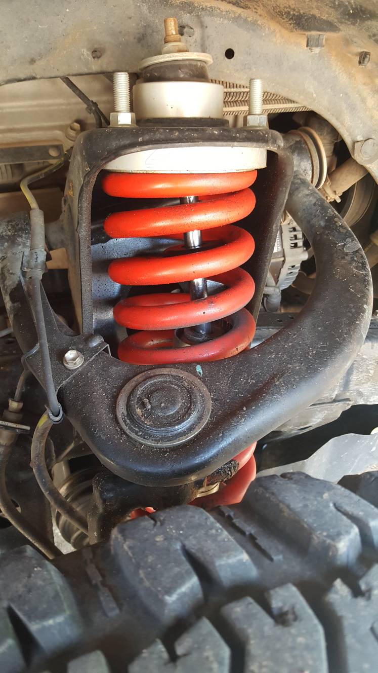

That's the classic failure mode of a shock that is too long for the bump stop. (or spaced down too far). The suspension bottoms out on the shock, overstressing it. Is that white disc just above the red spring a top-out spacer? Top spacers can lead to that kind of failure if you bottom out hard.
That is the aluminum top of the Toytec coilover. I simply bolted them on, and added wheel spacers to fit the 285's. Compared to most I wheel easy.

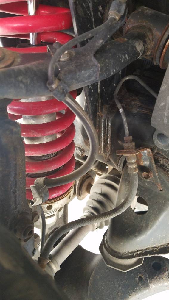

EDIT: Upon further inspection in your last picture the coil just above the tire in the picture is rusted and worn looking like contact at full droop with your UCA....I think you may have them set at too high of a setting and this would explain your premature failure.

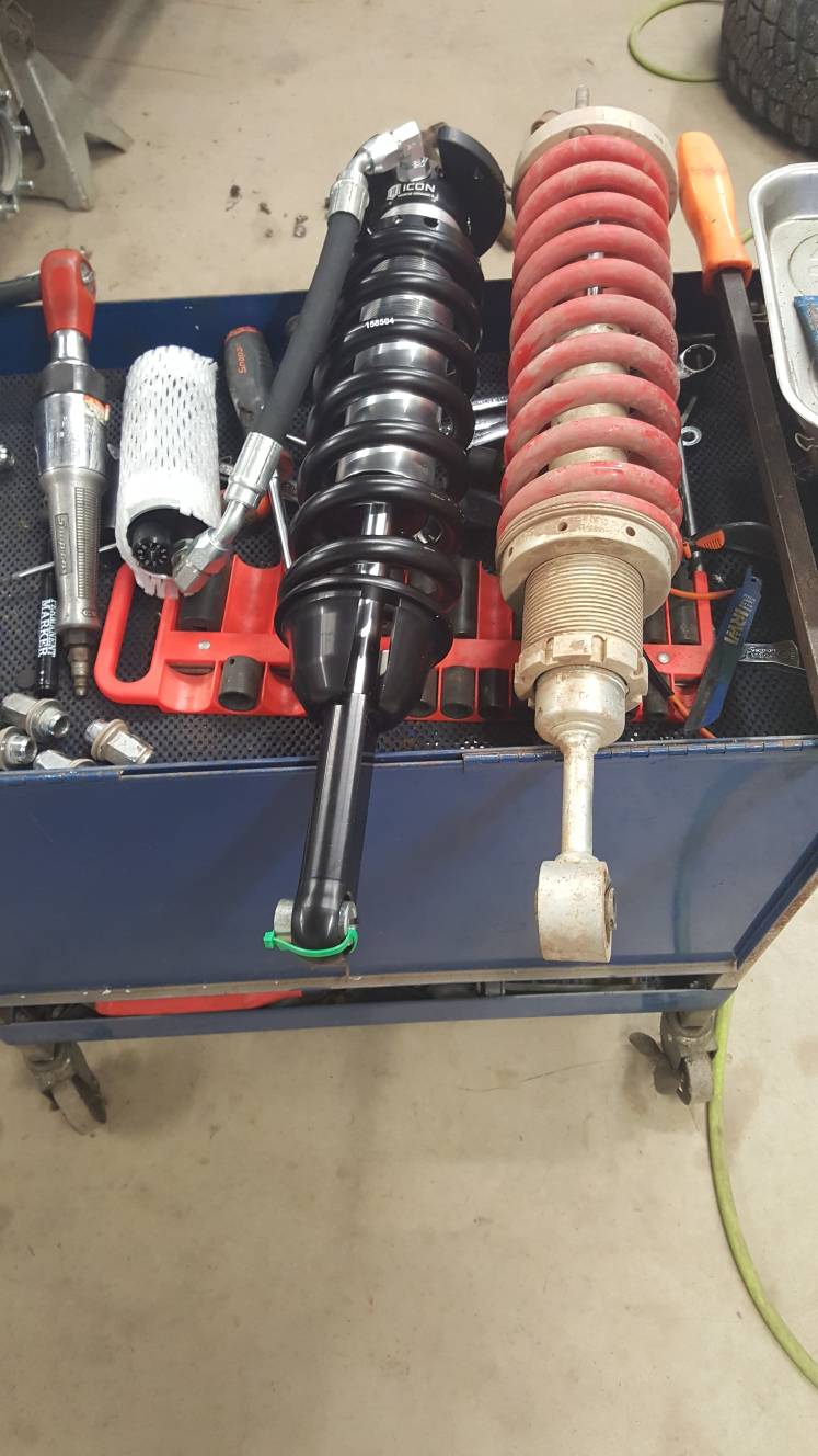

As stated over 60k on mine and I live in the midwest with the salty roads in the winter and my shocks don't even look like yours?!
For reference mine I just took a picture of
