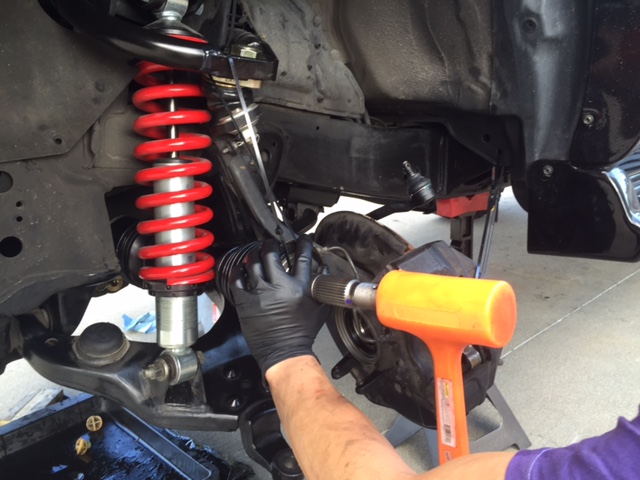

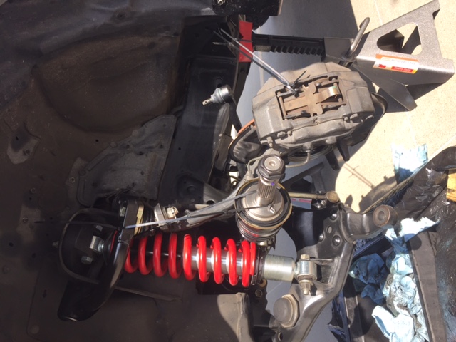

Followed his advice the first time i changed out my cv's and everything went suprisingly well. The only issue i had was trying to get the cv back into the diff. I ended up having to use a 3lb plastic hammer to tap the cv back in. I used heavy duty zip ties to keep the wheel hub out of the way and to suspend the cv so it was parallel to the ground. If you have a good quality pry bar it should pry out pretty easily if you keep working it around. Its tempting to go rambo on it and start cranking if it doesnt come out right away but keep your cool so you dont dent anything. I used super lube on the splines just bc i had it but gear oil works too. Keep an eye on the inner shaft when installing everything bc sometimes it'll want to come out of the joint (within the inner boot) if its ever left just hanging.
...having to use plastic hammer since i couldnt get it seated all the way by hand
