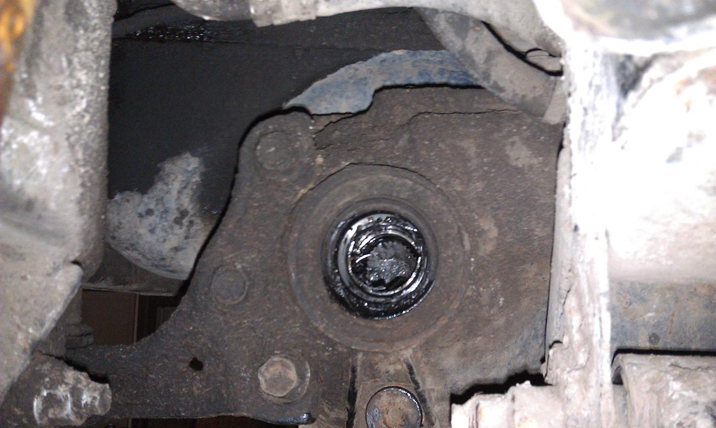

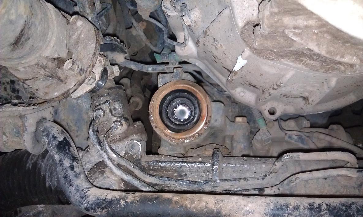

A friend of mine was driving into town a few days ago and was in 4wd when the front diff said BANG! The reason it put a death hold on the driveshaft and drivers-side cv is not yet determined. It sheered both of the pinion shafts. the passenger side was unscathed.
It's a 98 tacoma but I figured it still applied, and that some of you would get a kick out of seeing it.
carnage from the driveshaft slamming about.
drivers side

he opened it up and found plenty of fluid, 2 broken ring teeth, 1 broken pinion tooth.
It has been super cold out the last few weeks. it's 1 degree out right now. truck has a lot of miles too. ~250k. there's probably a mess of factors that contributed to it.
Aha... you are using much bigger tires.... This is probably the main reason.

I would contribute the death of this differential to the diff drop.
It may have had plenty of oil in it but was obviously at the wrong level. The pinion bearing ran dry, caused some slop in the pinion broke some teeth, locked it up or the bearing itself locked up and the locked the pinion up destroying it.

That is a crazy break, I've ran a diff out of oil and basically the gears get so hot the teeth just snap off, no ill effects to the rest of the drive train, it just felt like it popped into neutral. That looks like a severe shock load, like from hopping the front end while pinned. Or being bound up and trying to get unstuck.
That said, it's no secret the front 7.5" is a weak point.
