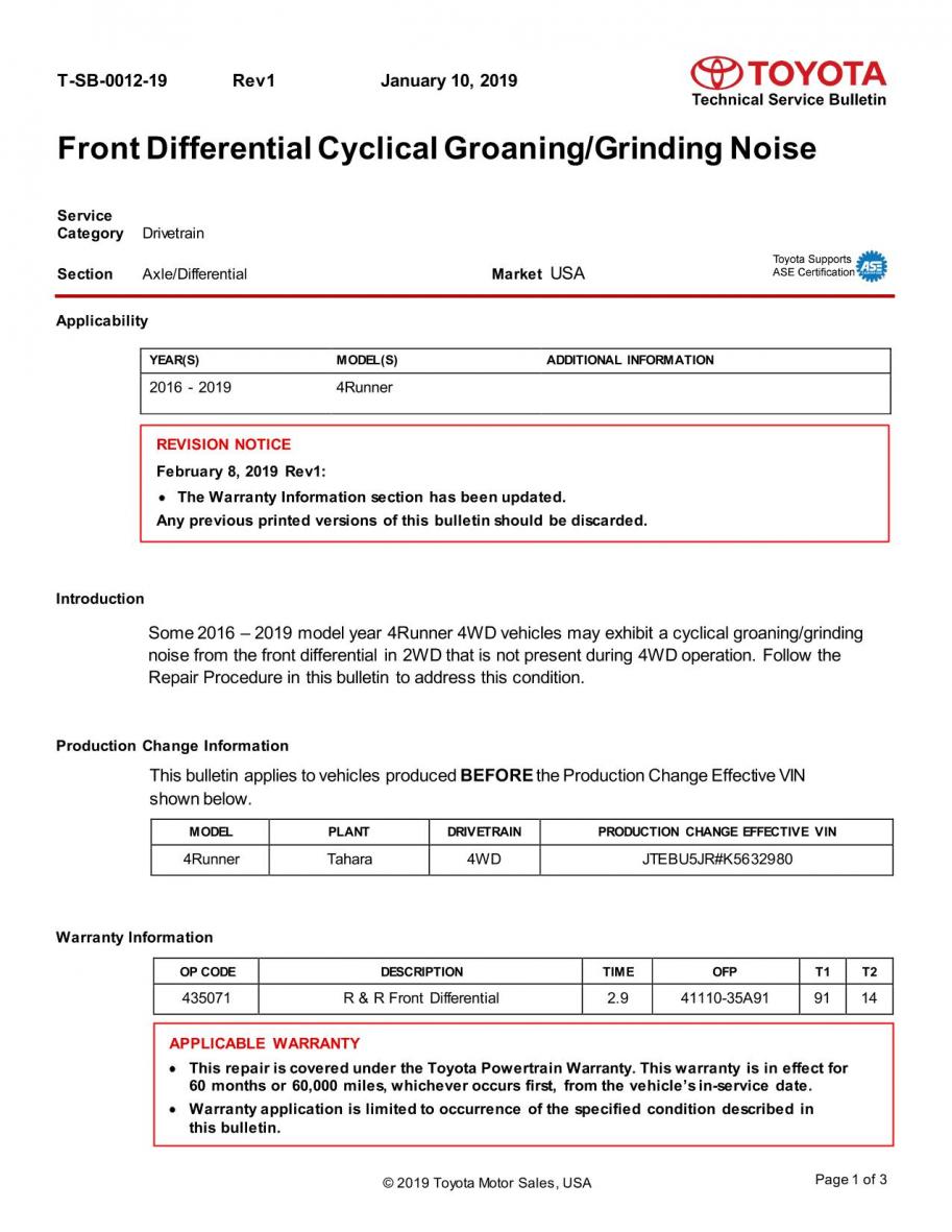

Had this issue and repaired under the TSB shown below, now after 10k miles the same issue is back. Has anyone had this issue come back twice? For reference its a 2019 w/52,000. The TSB was completed at 42,000. Thanks for any input.
Good info here, thank you both! I will plan on doing this work myself. Will be a uh.... fun project. >.<
Here is a video from ECGS pulling the needle bearing out (using their pull out tool that you can buy) and putting the bushing in (also using a punch you can buy). Does not seem too hard. The tools are expensive for never being used again, but is worth it to me. I plan to do this when I install my lift later this year.
https://www.youtube.com/watch?v=WnA_R3gFf2s&feature=emb_logo
Mine was replaced at 42k miles and now it’s doing it again at 46k. I had a new diff installed under the TSB. Just going to go ahead and do the ECGS upgrade.
