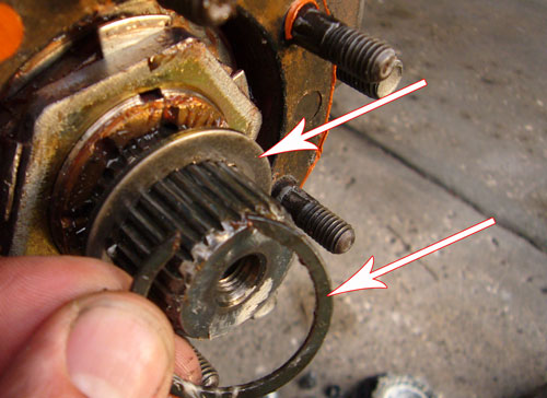

So i have the cover for the manual hub on passenger side off, and discover the halfshaft isnt all the way into the hub. drivers side is fine, got front end in the air and turned the tires. everything turned EXCEPT driver tire...its got the AISIN manual locking but not sure how i can get the extra 1/4'' - 1/2''??

I believe there is supposed to be a ring clip that goes on before the hub goes on. Then a washer and bolt go on after the hub is installed.
the spines for the wheel-end of the axle arent even into the hub, and i cant get any play to get it to reach the outer teeth. were they different length from driver to passenger and maybe someone didnt know what they were doing in the past or what?
i dont have the entire hub apart, pretty much broke down to that bottom pic you posted. except my axle is like 1/2'' to 1'' further in
You need to pull the axle out, it does move. More than likely your are missing that ring clip or it is broken.
thanks, first time ever messing w/manual hubs, lol. so pull the axle out of the diff, then it should come right out?

Theres a pic of it. was reading that some (depending on year) had the c-clip and some has a 12mm bolt. mine has the bolt, if that changes anything
Yours has both. Or it should, anyway. My '86 does.
You're right that that axle isn't nearly seated in the hub. It's going to stick out of the hub about an inch when it's fully seated, and you'll see the channel for a spacer and the c-clip. If you look at your good side, you'll see what I mean. The 12mm bolt and washer in the end is insurance in case the clip fails.
I think you might have a wrong CV though, because I'm having a hard time envisioning the tripod joints compressing enough to let that sit like that. In theory, once you unbolt the CV from the axle flange, it should drop right out. In practice, there's no way in hell, and anybody who says their CVs drop right out is lying or has a deal with the devil. :D
I'd replace the CV shaft. They're cheap. Pound the studs out of the axle flange while you're doing it and save yourself a headache.
