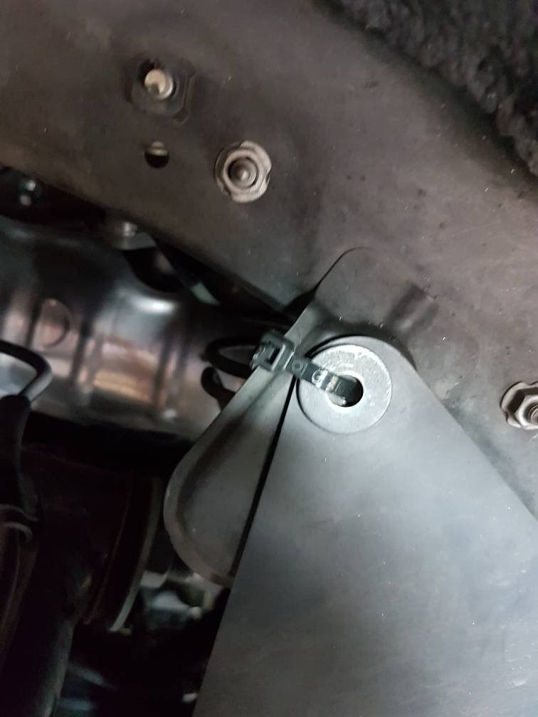

Your noise is most likely caused by the plastic clip fasteners for the rubber splash guard. You'd be surprised of the squeaking those things can produce once that piece of rubber starts flapping around. I didn't bother asking a dealership to replace those and did this instead. Been 2 years, no issues.
Sent from my SM-G930U using Tapatalk
Did you do this to all the fender clips or just that one?
I did the two on the top side of the driver side wheel well, the rest weren't squeaking.
That being said, I just saw your video link, seems the noise is consistent with the rotation of the tire so it'll probably end up being something else. The squeaking I had was at a higher speed.
