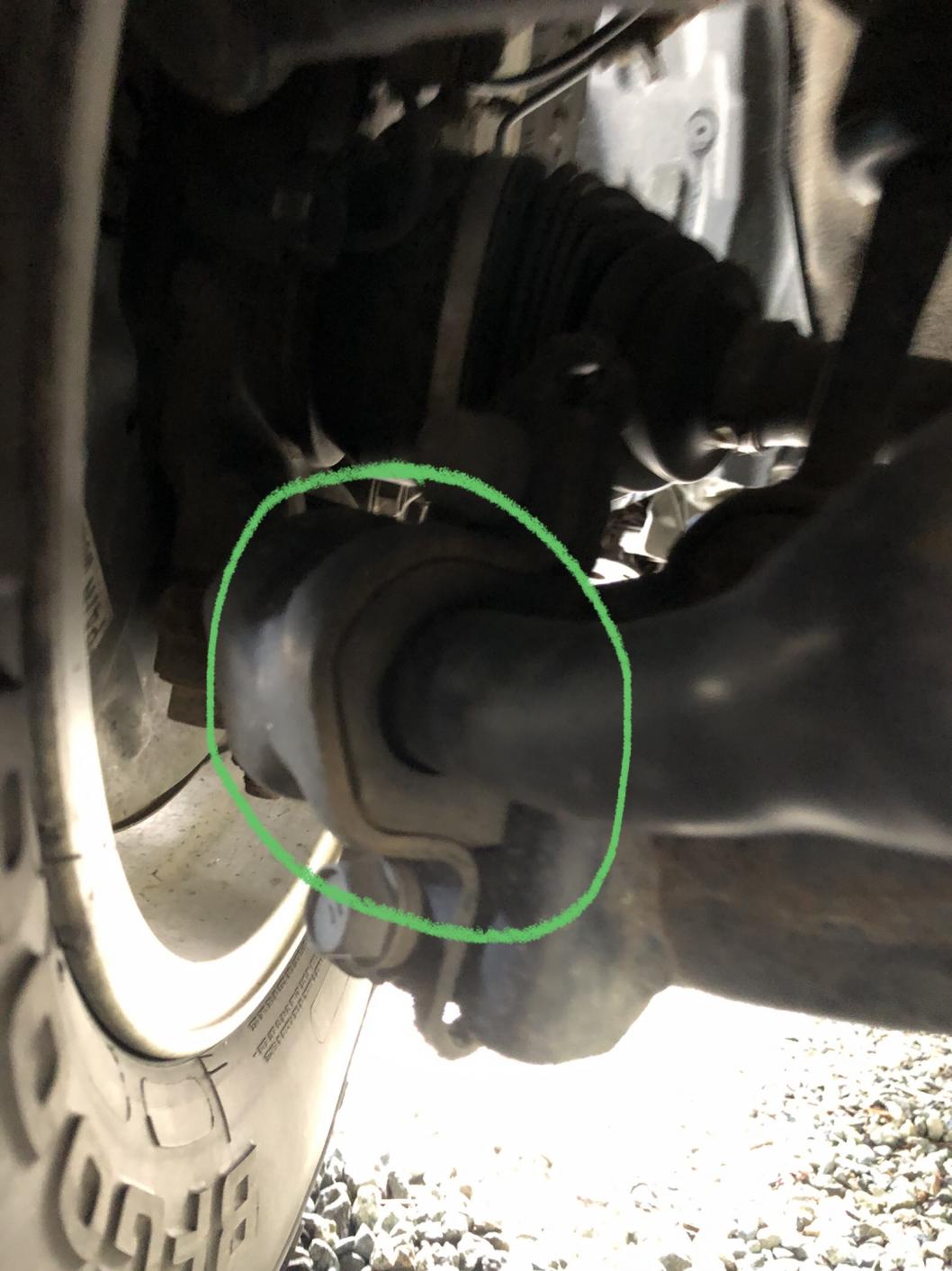

I think maybe(?) I found the problem or at least where I’ll start replacing parts. Looks like there’s a small gap on the passenger side bushing.
Thoughts on oem vs an aftermarket brand bushing and changing it while the vehicle is on the ground?

I think maybe(?) I found the problem or at least where I’ll start replacing parts. Looks like there’s a small gap on the passenger side bushing. quote...
put a silicone spray on that rubber and then changes that noise ..
I don’t understand this. The noise is a clunk. Not a squeak or squeal. Sorry if I misinterpreted what you are saying and I’m happy to try almost anything.
