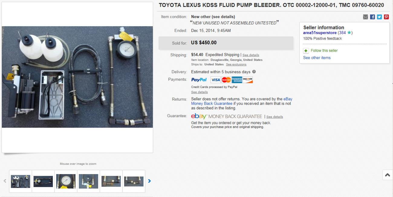

I actually found the Toyota HP pump on Ebay for $500 and bought the AHC fluid at Toyota for $45. The Service Manager at one dealership printed the instructions for me and so I did it myself.
Misterquad, I am sitting on a $1600 KDSS repair/service bill, and would love to get any info you could provide on what you bought, and the service procedure.
-Pump Part Number
-ACH Fluid Part Number and Cost
-Bleeding Instructions
If the instructions aren't digital, and I could somehow get hard copies from you, I would be happy to digitize them, and post them for everyone. Photos would work as well.
