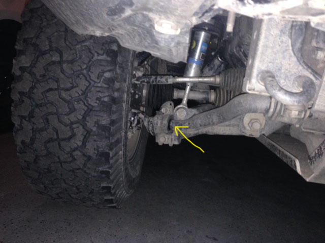

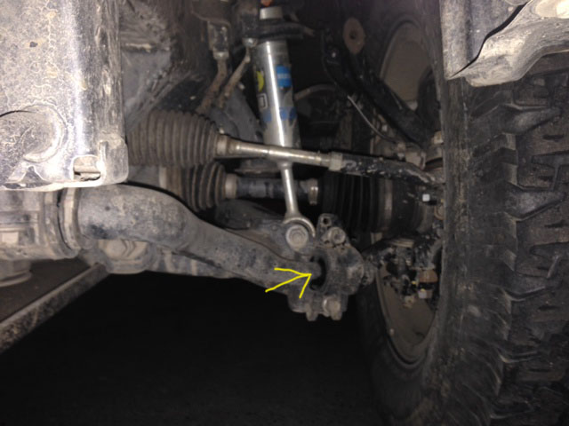

I noticed something that could be the source of the problem. It appears that the sway bars has a lot of side to side play in regards to the bushings and end links. I took my car off roading and inspected the KDSS sway bar in the front. It looks like the dirt has been rubbed off on both side where the bushings attach front the end links to the sway bar. This could indicate some "wiggle" room and could be the source of the clunk. I'm hoping someone with stock un-altered KDSS suspension could chime in... if your sway bar is completely dirty near the end links after going off road a bit it might be I didn't tighten those end links down enough... my problem is i literally couldn't tighten the bolts anymore. Please see the "cleaned" area where my sway bar is connected.

I would say that is just from the normal up and down cycling of the front suspension. As your LCAs droop those sway bar mounting points get closer to the centreline of the truck which wipes the bar. Simply driving down a bumpy road would most likely have the same effect. The bushing is there to allow for play and give in the system. You don't have to crank those bolts down super tight; all they need to do is clamp that bushing in place.

I had a clunk that replacing those outer and the inner bushings resolved. The bushings had been greatly enlarged after 100K miles - I could stick a screw driver between the bushing and swaybar on the outer ends and move the swaybar in the inner bushing vertically with a prybar. After replacing all 4, no more clunk when going over uneven bumps.

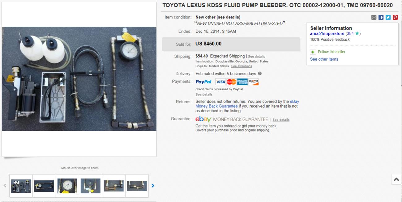

I'm facing serious clunking now. Wondering if you'd be interesting in selling your pump kit. I cannot seem to find one priced the same as when you bought it.
