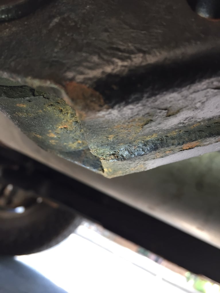

I noticed when under the vehicle that the passenger LCA is cocked at an odd angle where the driver one is straight on.
It’s hard to get a good photo, but hopefully this shows it well enough.
Does this look like it would cause odd sounds? What’s the remedy? Loosen the bolt and hammer on the LCA with a rubber mallet to try to move it back?

It looks like that bracket is broken. See towards the bottom of the picture where the metal overlaps on the bracket? I think you struck something with it, now its bent and cracked and when you flex the suspension that overlapped crack shifts, making your noise. You'll need to take that to a fabrication shop that knows what its doing with vehicles so they can get it straightened and welded back. Or you could just hammer it reasonably straight and weld that crack, but perfect symmetry would be much better.
S**t good eyes - if that’s true then I can’t believe I didn’t notice it. It does look like it in pictures. I’ll take a closer look tomorrow and if that’s the case then just weld it up myself.

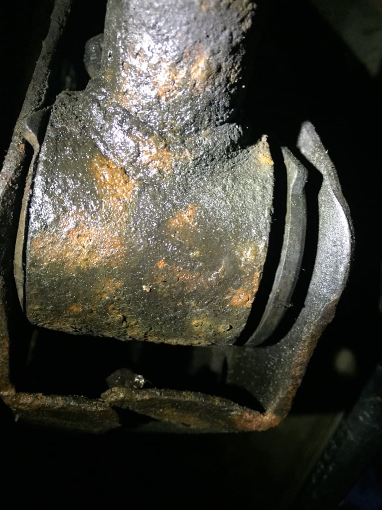

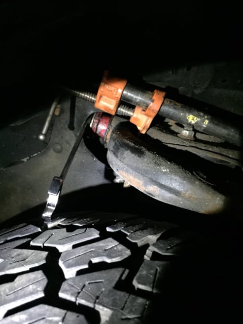

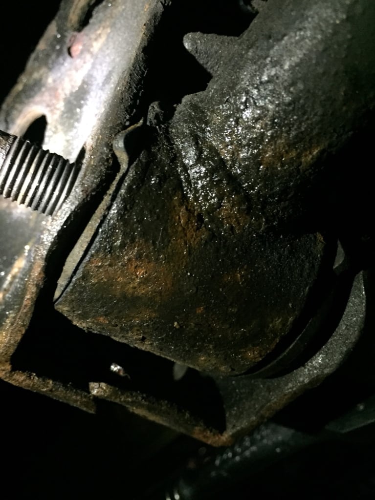

Tonight I did loosen up my front UCAs and tighten them back down. When doing the driver side one I took the nut off and turned away to put some anti-seize on it, turned back and my damn UCA had shifted, almost popping the bushing completely out.
It threw me for a loop for a minute, but I used a pipe clamp to take up the slack until I could get the nut back on the threads to tighten it up.

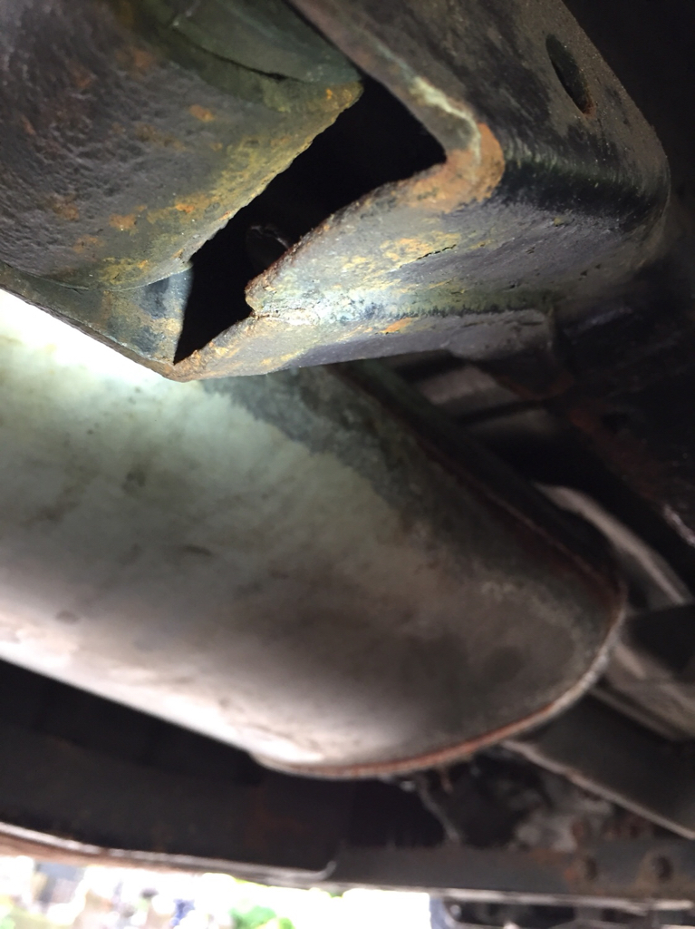

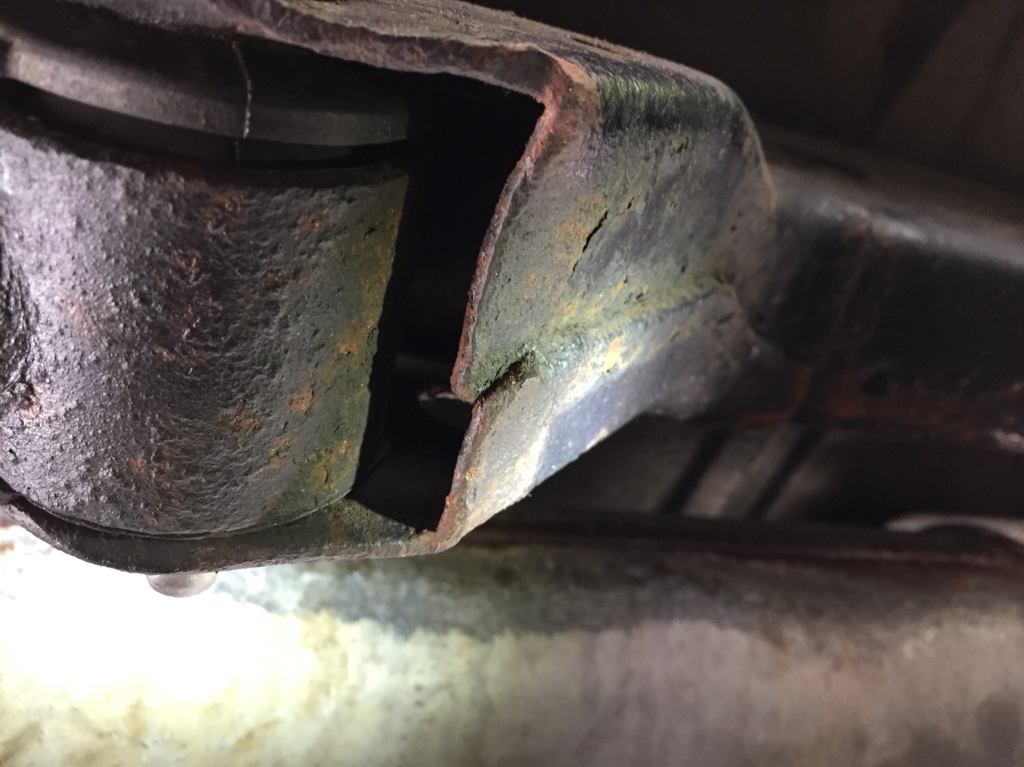

Took another look at that LCA mount and felt around a bit. I don’t think it’s cracked, I think it was just bad lighting. Seems like it came from the factory like that.
In the first pic you can see the seams are a little uneven and the light creates a shadow. In the next 2 you can see it’s still pretty solid
