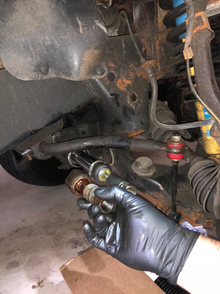

Put in new inner tie rod ends, mine were shot, they had a ton of play and dropped immediately rather than holding themselves up. That was a really easy job

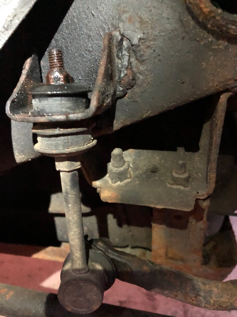

Also replaced my rear sway bar links, they were pretty beat up. Here is a pic of the one that was in better condition - it’s got 3 washers on it, is that normal? When I replaced them I only used 2 washers.
Anyway, the truck drives better, but the noise is still there!
The picture you posted here is correct. Two washers on the bottom, one on the top. The top washer on the lower side centers the link rod and keeps it from rubbing on the frame mount.

The front end of my 96 started making some creaky noises about a month ago, Ive only had it for a couple months and the previous owner had recently installed 99 springs and bilsteins. Also looked to have new sway bar end links and new steering rack. The noise gradually worsened. I replaced the lower ball joints and tie rod end links which were in bad shape. This did nothing to improve the creaking and groaning. Finally a couple days ago I started spraying everything down with grease. Barely any improvement. Finally I realized that something must be loose. I went under it this morning and sway bar link was not tight at all both sides. Also the lower shock bolt was way loose both sides. Tightened it all up and now much less noise. Still a little creaky when I brake from slow. The top shock bolt is also very loose but has quite a few threads showing. I'm guessing this is normal. Any idea of how to tighten it while its attached? the small shaft out the top is pretty fixed to the big nut and they turn together. can't get enough leverage to turn the nut while holding the shaft still.
