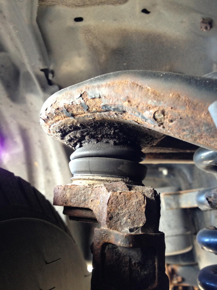

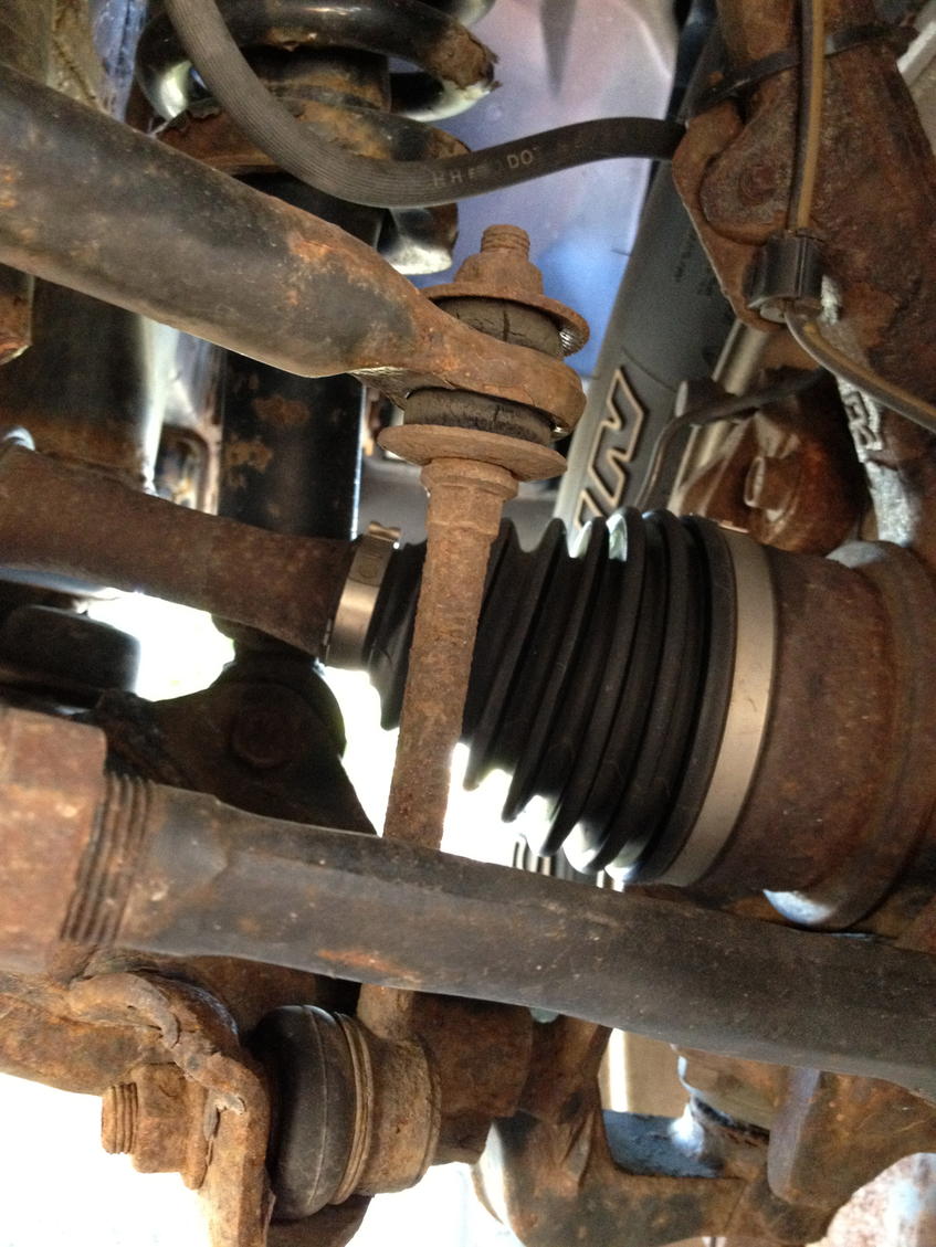

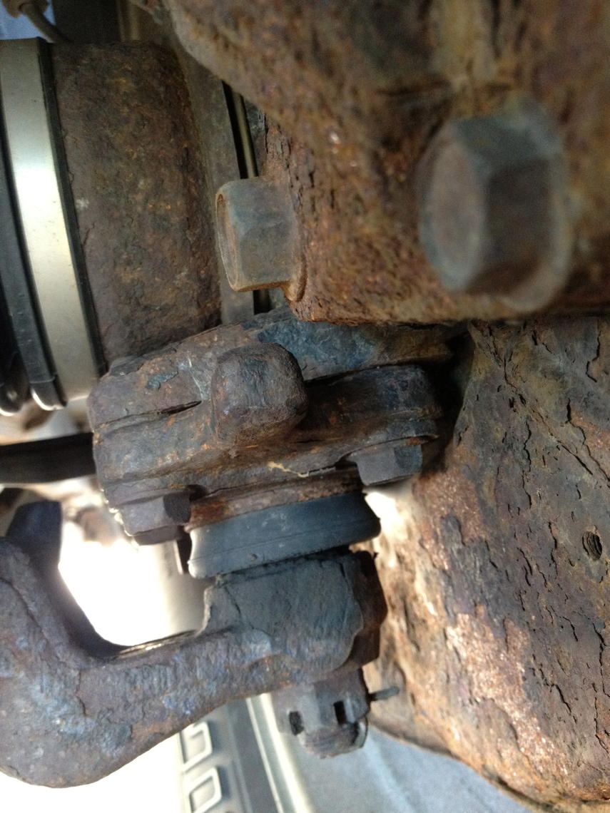

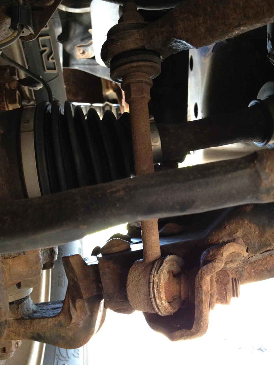

Well i got under there today and noticed driver side sway bar link (stabilizer link) dry rotted and rusted to hell! Check out pix! Everything under there looks pretty dried out! Should I replace both sway bar links and bushings on the center of sway bar? Should I replace with OEM or aftermarket?

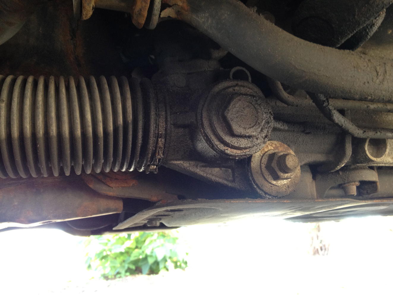

Also, looks like there is some leakage coming from driver side of steering rack. It could be from something above and I have not tried testing for excessive play because I need another person, I'll do that tomorrow and probably end up installing new bushings for now.
Can you guys see anything else in pix that needs to be replaced?
The truck is very clean, but front steering it sloppy and I want to tighten it up before winter.
Thanks again

Yeah, that all looks like a hot mess of rust, but still nothing that'd make me say, "yep, that's why your truck handles poorly."
Seriously, given the nature of your undercarriage rust, get those LBJ's/tie rods/steering rack checked... if not by you, a shop will probably do it for free/cheap.
that one sway bar link is toast. also, if the steering rack guide is loose you may experience a little play. that may also be the cause of that seep on the steering rack.
