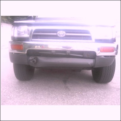

I was in an accident this morning I rear ended someone. " they are ok, there little car is a mess though"..
My 98 SR5 4*4 is just a beast!! the chrome finish on the bumper has not a scratch. Although the plastic housing assembly below the bumper is all jacked!! I need to find a replacement. This is the unit that houses the fog lights. I guess you guys know you also drive em!!...
Please:
Can anyone tell me where i can find that plastics assembly. Even no there "i hope" is no REAL damage and its only cosmetic
This truck is my Pride & joy. " yes my kids are to, but this is my 4-runner were talking about...
I also need the Fog Lights.. Hella is poss.

Does anyone know how to take off the Valance. The bolts look almost like clips.
i think they just come out with a driver. Not sure...
Anyone ever do this step yet>
Yeah, they're clips. I took this off while replacing my air compressor and dryer last year. Basically, you'll need a long flathead (smaller head) to compress the clips. Have someone pull the area off that you're pressing with the screwdriver. Don't worry about being TOO careful since you're replacing the whole part. It actually comes off fairly easy and is more durable than you might think.
thanks for the heLp on this one!
replaced with 99 version. Looks great.
Clips were nasty to get off basically cut the valance all up while stripping.....
