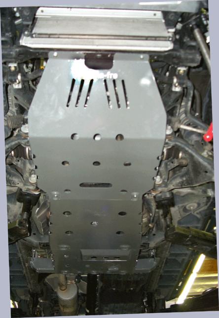

I took mine off and sand blasted it so it could be powdercoated. The metal was so thing that blasting the rust off left me with a ton of holes. I replaced it with a Mano-o-fre skid and really like it.
This one?

I do like that skid plate, but it'd be a hard sell to the wife since I'm lifting it.

I have the Man-A-Fre and am very happy with it. It is thick steel, inexpensive, and just looks tough. Come by if you want to see it.

Does it have the hole to access the oil pan drain, or does it need to be removed???
