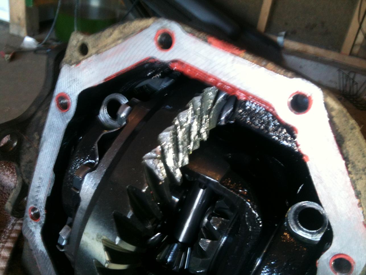

I'm going to pull the old one apart on Sunday so I can identify the problem and have the whole thing rebuilt. I'll take some pics of the inside so we can all enjoy.

I think tearing your existing one down and having it rebuilt is an awesome idea. I second Hyde, need pics of the carnage!
Well there she blows........ I'd say that's fairly well destroyed.
