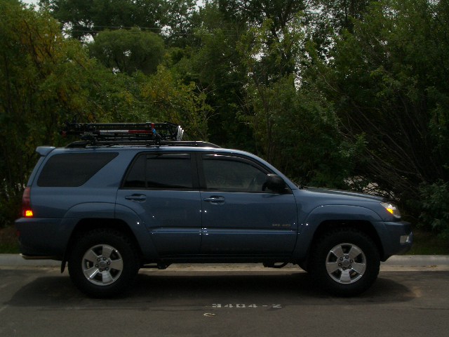

if u do the front only, IMO, 2.5 will be too much, 1.5 to 2 at most will still keep a rake & the running boards should look fairly level instead of running up hill. heres mine, it will give u some idea but not everybody gets the same results depending on things like how much the springs have sagged, etc. i did a 2in. front (adj. COs) & only used 5100s out back with airlft1000 bags.

Did you put any lift on the rear, or just the front? Looks great! What do front spacer kits generally cost installed?
I had just the topout spacer from toytec up front the spacer runs about 60 and about 200 to 250 to install with alignment. I ran this setup for awhile never had any problems the people who own it now like it to. I recommend this since it doesn't preload the spring and still rides like it did from the factory
