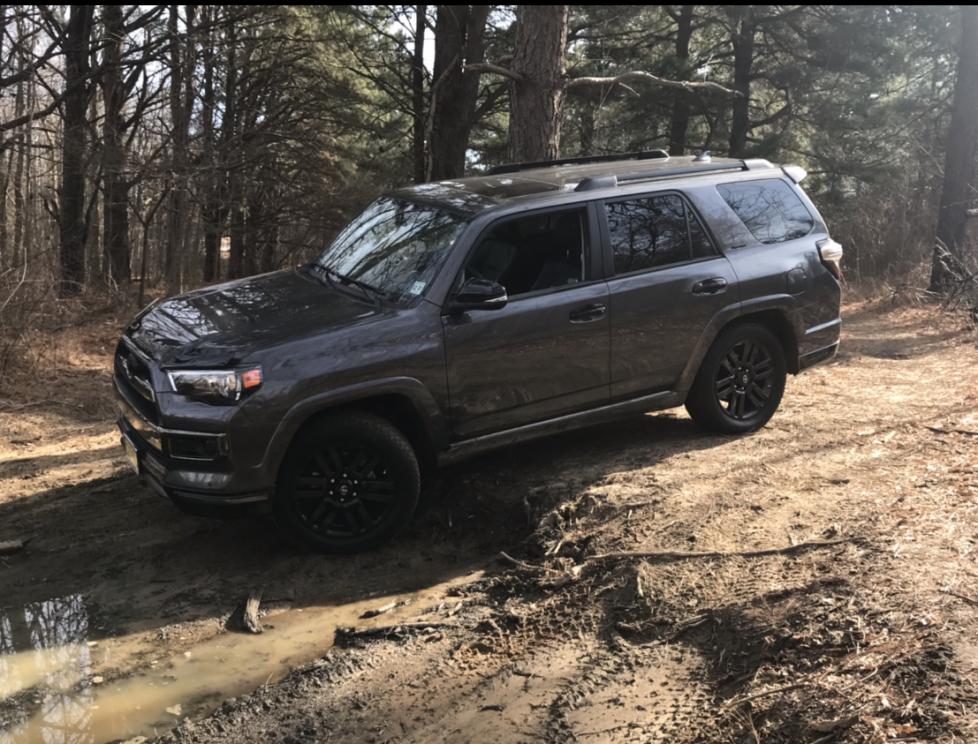

I have a 2019 le nightshade and got it brand new and although the sound system is nice the front passanger door rattles so damn bad and either low or high volume. This is literally driving me nuts. Any one else have this problem
Heres a link of the sound its towards the end of the video

My 2012 LE never had that problem. Is the door panel seated properly? You could try looking for bulges or places where the panel isn't flush. Others will eventually pitch in with better advice. Can you be more specific or detailed about the problem? Anything make it worse?
Its a rattle/ vibration noise through the entire front passanger door panel. I understand turning up your speakers will make a vibration but it sounds like a. Door from a 91 civic with 18inch subwooofers in the back.
Turn up the volume makes its worse but even at low volume it rattles, i will take a video only way to show you and i will also check the panel
My 2017 Offroad has the same problem and my cheap solution was to buy a thick foam black beer koozie and put it in one of the cupholders in the door. Fixed my problem, 1 1/2 years going.
With the added benefit of insulating your beverages.
OP: at the 5k service interval, the dealer will probably just check your fluids and send you on your way.
Just buy a pack of CLD tiles and install them on the door, helps if you can pinpoint a little better where the rattle is coming from
