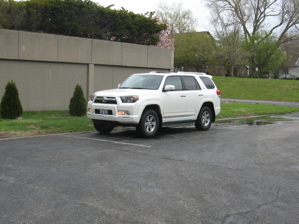

That's exactly what I wanted. I put on 5100's F&R, fronts set at .85. This is what it looks like now.
Yours looks good. Is there any rake remaining? After seeing yours I think going over .85 would = saggage.
