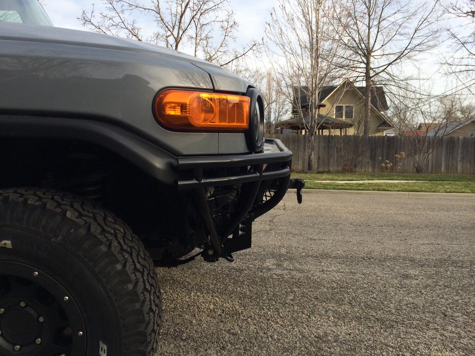

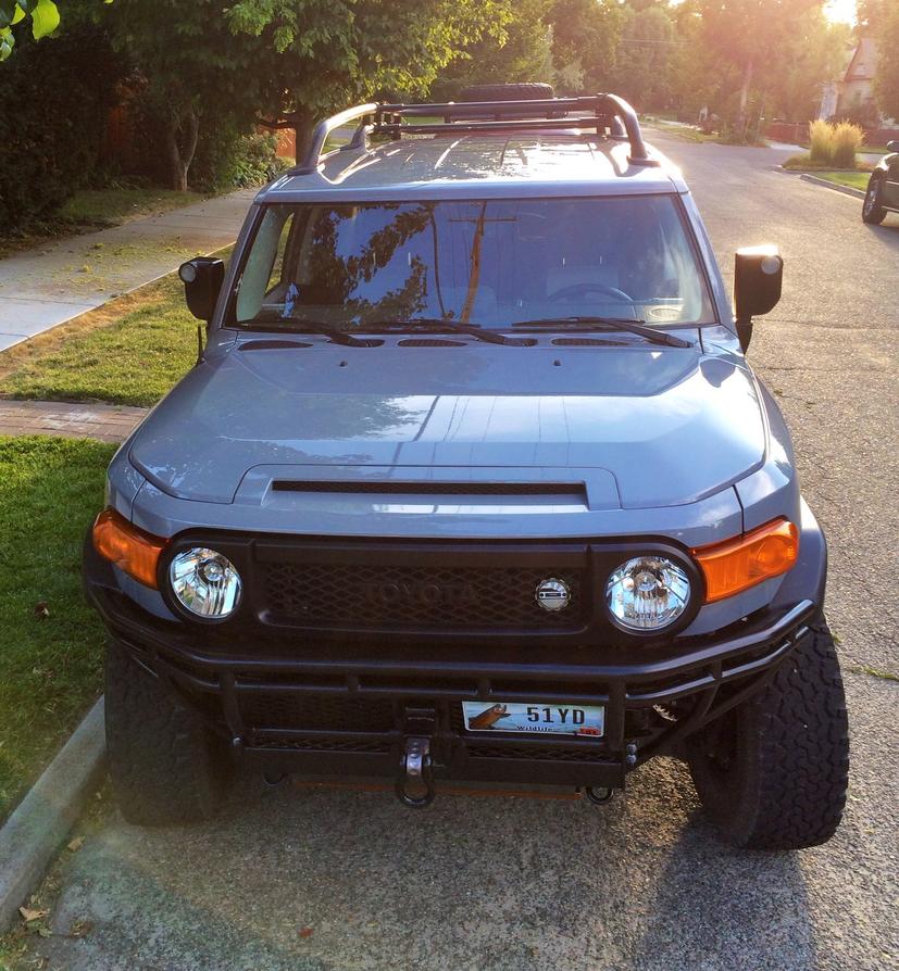

Here's mine on my FJ. Built by Hardline Fabrication in South Carolina.
