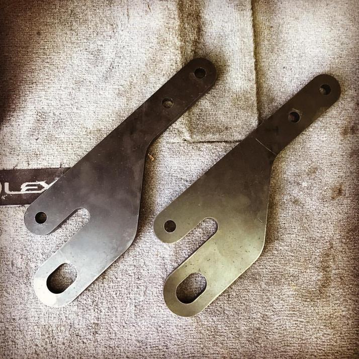

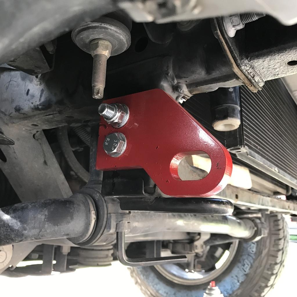

I manufacture heavy duty recovery points for 4th gen/GX470 that work with factory bumpers. Its an inexpensive option for heavy duty, rated recovery points without having to shell out $1000+ on a full bumper. I had a lot of questions at Lone Star Toyota Jamboree and on various facebook groups about making a recovery point for 5th gens/GX460. So i've done that.
These will fit with a factory bumper and an ARB bull bar, possibly others, those are just the two I am sure about. They'll be laser cut from 1/2" steel plate, and rated by ATSM-E4 standards (don't have that done yet, but its coming). My minimum rating will be 10k lbs per point, i'll have to do a redesign if for some reason it doesn't get there. I'm confident it won't be an issue based on simulations.
I just got my first two prototypes back to verify all my measurements and fitment, as well as get load testing started. So with all that said, i'm thinking pricing will be around the $150 mark for a pair of powder coated recovery points with hardware.

here's my 4th gen point installed:
here's the prototype 5th gens I got from laser yesterday:

I like the idea, but i'm not sure about $150. Not sure that would be worth it for me at that price.
What is compatibility with skid plates like ARB.
Also ... what is idea behind the oval hole vs a round hole. A round hole would be better suited to a D-ring.

These bolt on the outside of the frame rail, skid plates should not be affected.
The oval hole allows you to use a soft or hard shackle.

Correct they do, it will work in conjunction with arb (no recovery points on those). If you've got a full replacement with recovery points, these are unnecessary. The idea is to give an upgraded solution that will work with a factory bumper, designed and load tested specifically for a recovery.
Regarding the factory tie downs, i've never seen or heard anything from Toyota that specifically states the intended use, what kind of loads they are designed to withstand, etc. They are certainly used to tie the vehicle down for shipping, but beyond that who really knows. I know my 4th gen points are load tested and certified to 13000 lbs, and these will have also receive a rating. They were designed specifically for recovery.
