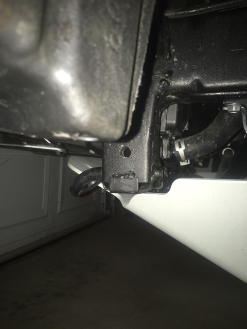

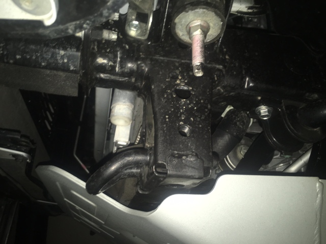

The 5th Gen recovery points on mine looks like it goes through the box and out the backside. I do have the welds around the round bar where it enters the box and exits on the back side of the box.

You're right, it was a 120 platform, either a FJ, 4th gen, prado, or GX. The design on the 5th gen is the same though. I've attached a pic of a 5thgen for reference.
I honestly forgot exactly what it looks like....I just knew there was something different in that pic and I've looked at them before and noted there was no way they would fail under a recovery. I need to go look. My mistake.. the design could be similar. I would have to see them side by side... but pretty sure some of the other platforms were much weaker. I have a 120 and a 150 so will report back after I look.
I will say... the big issue with the factory ones is how you can bash down on them.. that will weaken them over time... the issue is not the initial strength.. but the location and the fatigue that could occur after many hard hits.... although I still doubt most would wheel that hard in the first place...
Correct, same design as 06-09 120 series rigs.
Yes wfo, that's another issue with oem.
