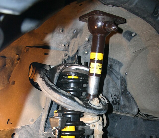

I'm sure you have figured out a way to get them in by now. Anyway, I did this a few months ago, but with Tundra springs and OME struts. The OMEs are a full inch longer than stock. I disconnected the sway bars and then used the factory jack positioned on the upper control arm and the wheel well and jacked everything down till there was enough clearance. (not my picture, but thats what I did)

Thanks Techno-
Yes, they are in and they drive awesome (Bilsteins HD). I levered the upper arm down with a crow bar, and it worked fine. I was afraid to put a jack in where you did it, not being sure if it was strong enough. But in retrospect it does not require that much energy. Thanks for posting that picture. It is a lot better than the way I did it.
JG
*falls over dead* I have been fighting with these new struts most of the day and was thinking of setting fire to the damn thing :rolf: but omg why didn't i think of that.... -runs back to the truck to show it who is boss-
