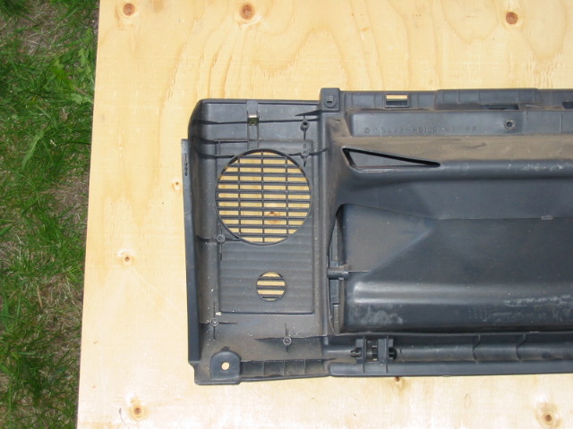

Here is what I am going to try, first here is the passenger's side speaker well/pod/hole/holder/captain's chair.

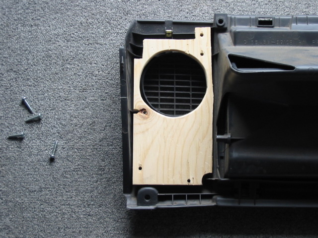

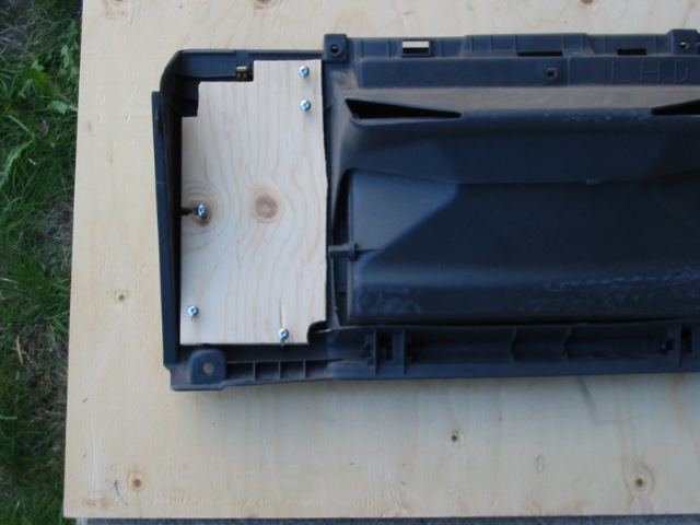

And here is I did to it, poor thing.
The idea is that this gives me a more sturdy surface to mount the speaker on, also is does a better job of separating air volumes between the cab and the back of the dash. You have to imagine this with a hole in it for the speaker of course.
Alpines are getting in tomorrow, I hope there is still enough clearance to install them.
The poor man's baffle system.

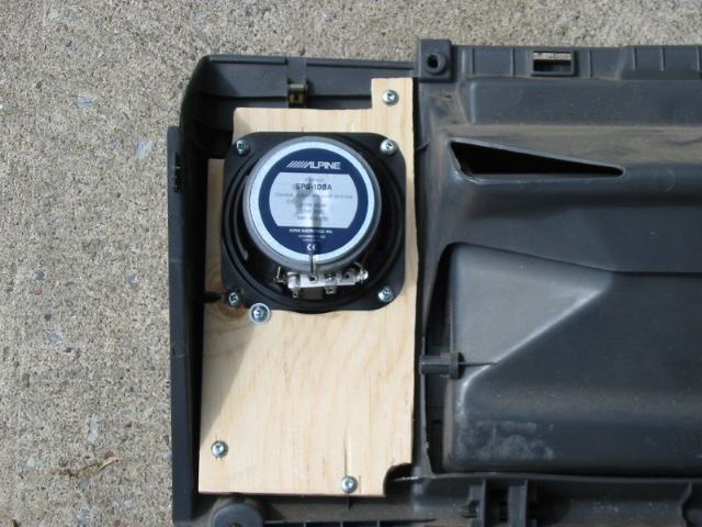

Here is the completed baffle ( is this the right word ? )

And here is the complete set-up.
The baffle is securely held onto the dash by multiple screws and the speaker has its four mounting points on a solid surface insted of two shaky plastic stubs.

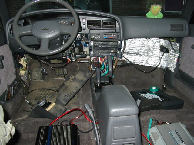

Oh and when darkness hit the cab looked like this.
