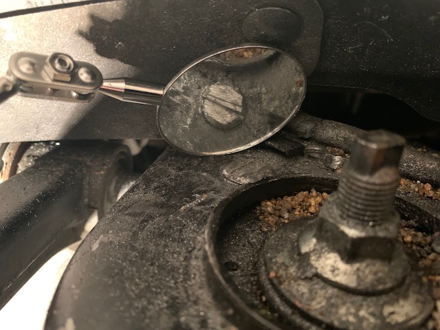

Hey ya'll - I am working on replacing my front struts and got into a pickle. I got one in just fine. On the second the hard to reach bolt in the back (top of strut) was fully stuck. I broke the tong off a wrench tugging on it. Then stripped it then cut it off. I had to cut just above the built in washer due to the tight space and I was cautious about damaging the mount.
Whats left is the build in washer and now I cant get it to budge. Possibly the top of the strut is stuck on there too. I have tried banging on that washer piece with a file to try to pop it off. I was wondering about compressing the coil and pulling the shock out and then the coil would hang free - might give me more ways to wack on it.

I'd get a Dremel in there with a sanding attachment and see if you can grind it down to the point you hit the top of the coil housing.
That is not a washer. It is a flanged nut so there will still be threads in that piece left there.
I'd try getting a cold chisel under that and see if you can pop it off. Of course grinding a little lower will help too.

F-YA! The Dremel did it!!!!
I felt like a dentist in there with the drill and the mirror. Only took about 3min
of shaving it down and then the "built in washer" ring just popped off.
